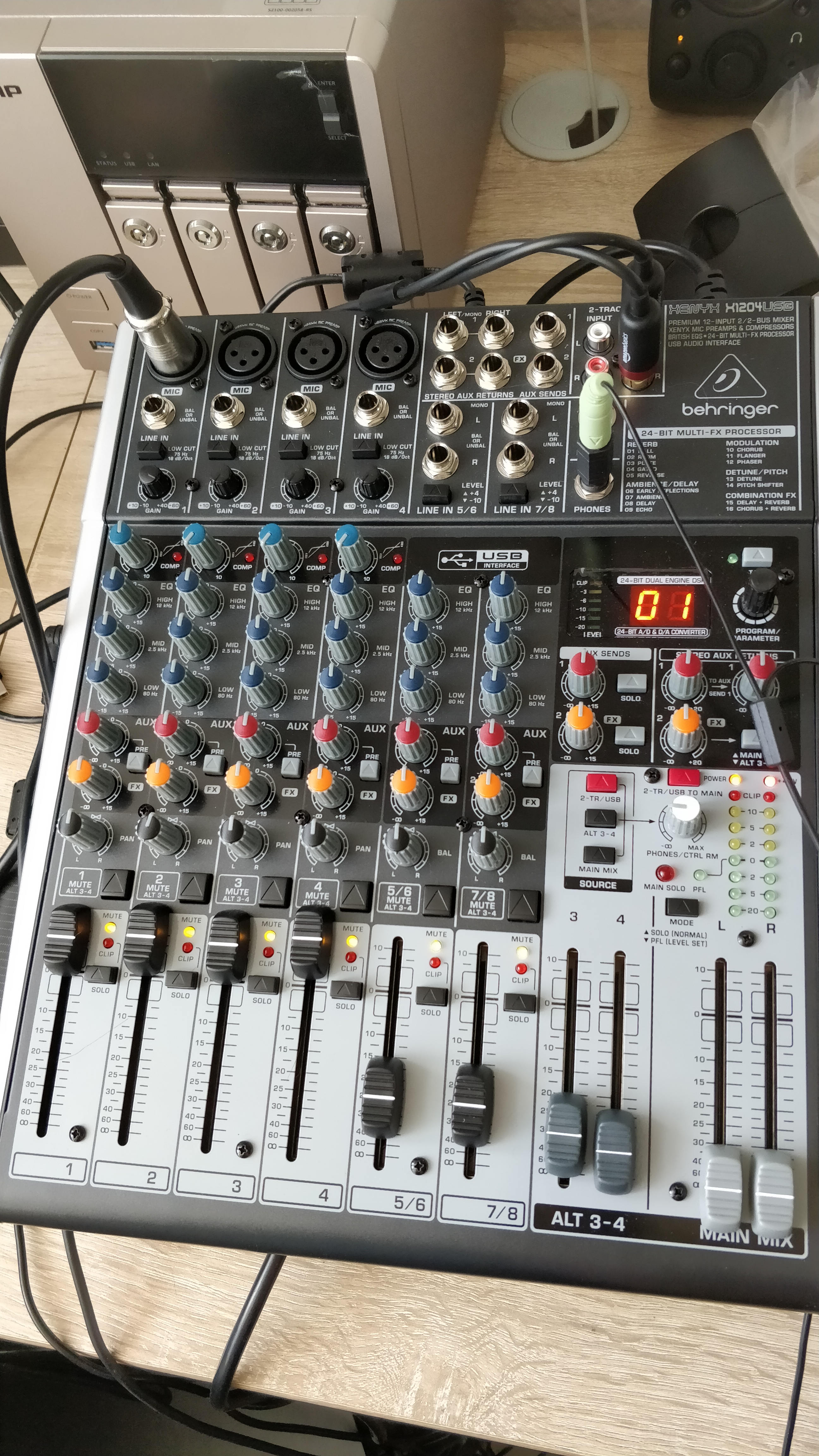

So I would like to send with my mixer (behringer x1204USB) and RadioBoss on the Internet radio. Broadcasting.
So I Have:
* Behringer X1204 USB
* RadioBOSS Advanced
* Neewer NW-800 Mic

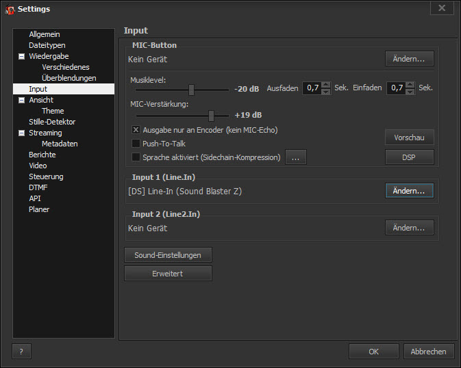

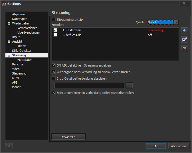

I connected my mixer via USB. The way back is via 2-track output to the PC (line.in)
I have also (I think) the right settings in the RadioBoss created. Also get the sound on the stream, but I can not get the mic on it.
I also want to control music volume and microphone volume with the mixer.
The settings appear to be correct, except for microphone. You should set it to "no device" (that is, disable microphone in RadioBOSS). Then plug microphone to the mixer and control it from there. RadioBOSS will pick it up from line input - so the microphone will be in the stream that you broadcast.
Having the same mixer i'm using another workaround but you need radiocaster or another encoder to make it work because i want to use that mic button in radioboss.
Audiocable from pc to mixer channel 5/6 and the usb from mixer to pc.
Set up your internal soundcard as the playback device in radioboss.
Pick any recording device as a mic (as long as nothing is connected to it) in radioboss
Set up the mixer as recording device in your external encoder (in my case radiocaster). You can setup vst plugins in radiocaster as well if needed.
