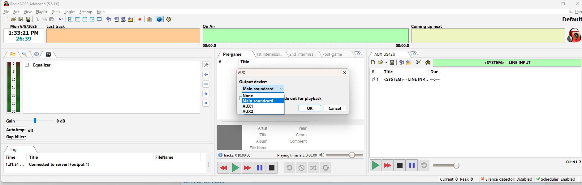

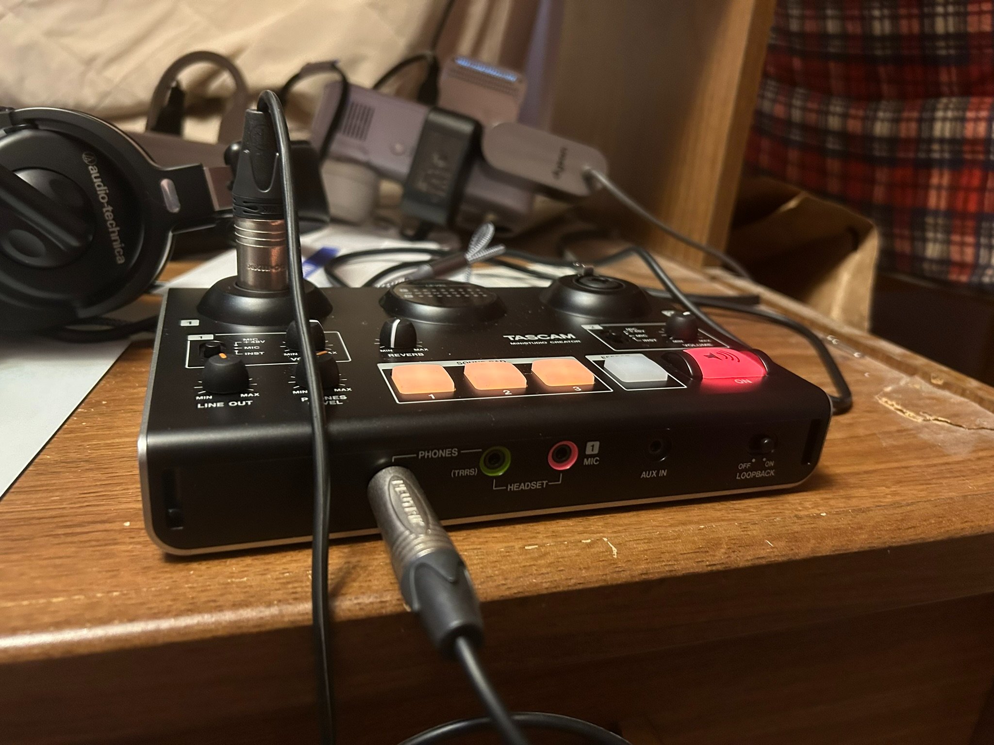

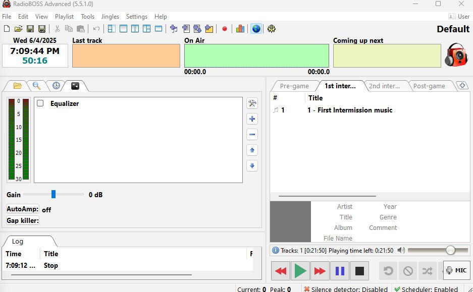

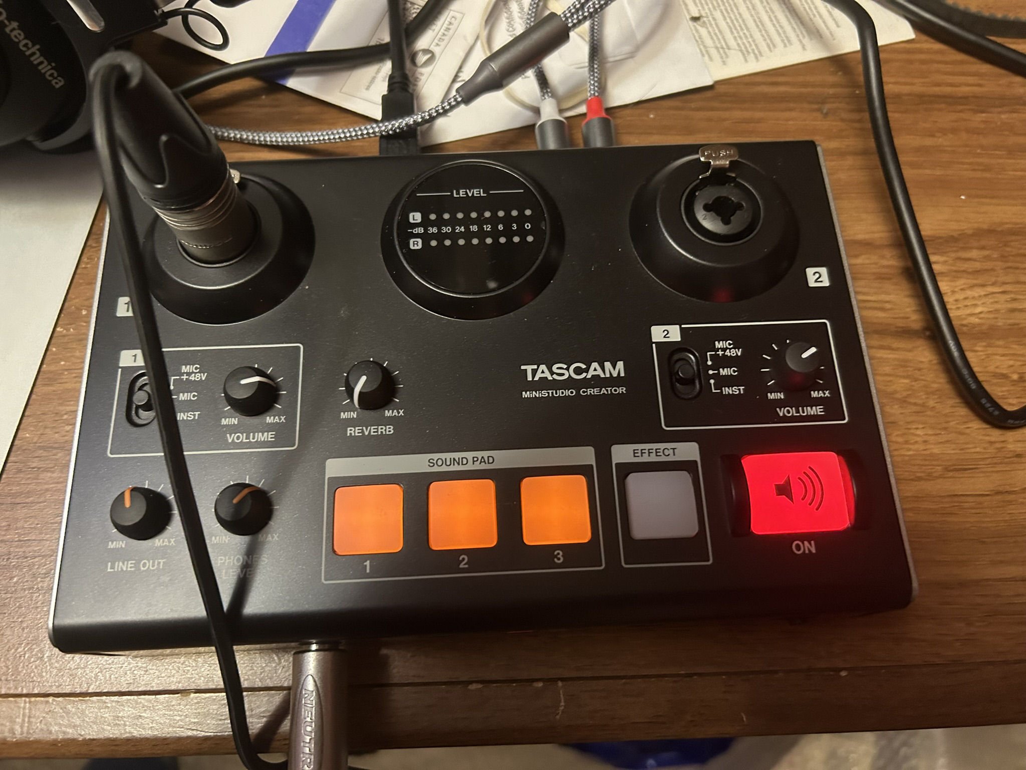

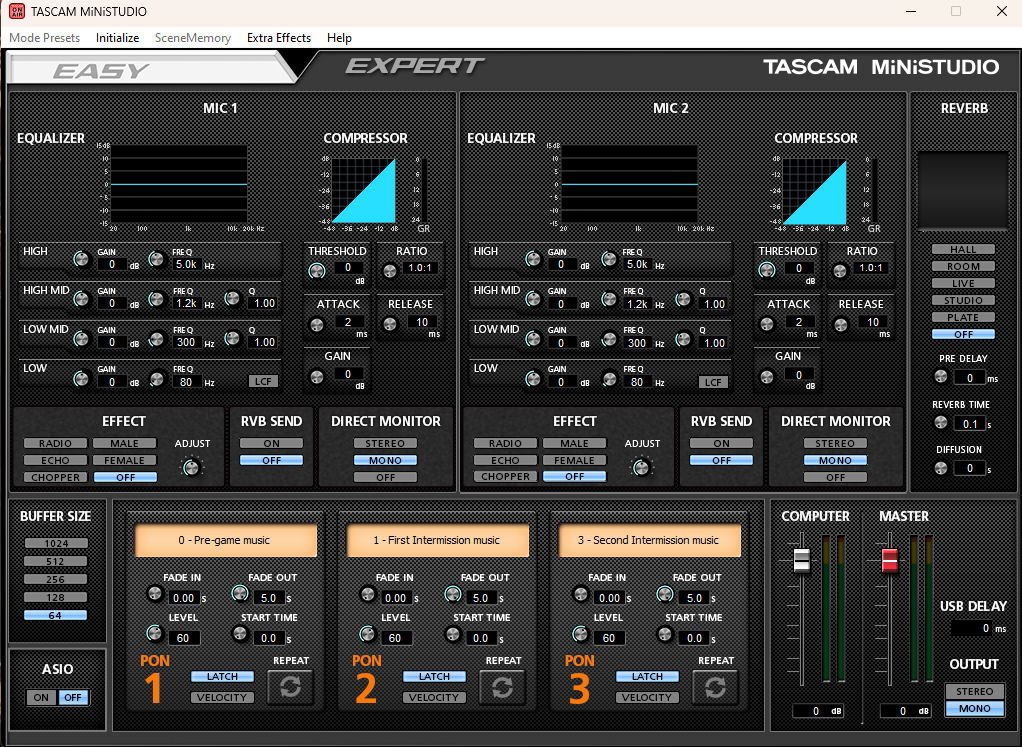

I'm creating a sports play-by-play setup with RadioBOSS (v. 5-5) and a TASCAM US42b USB audio interface. I've got it working well but I have one question: I'm trying to get the audio from the US42b sound pads to appear in the RadioBOSS green "On Air" box with the RadioBOSS mic switch OFF. (It shows up with the mic switch ON, but not OFF.) I realize I could play audio from the playlists in RadioBOSS but the US42b sound pads would save me an extra step and avoid using a mouse.
It's quite possible this cannot be done but I thought I'd ask.
I've enclosed some screen shots, which hopefully will allow a better understanding of my issue.
Many, many thanks in advance!

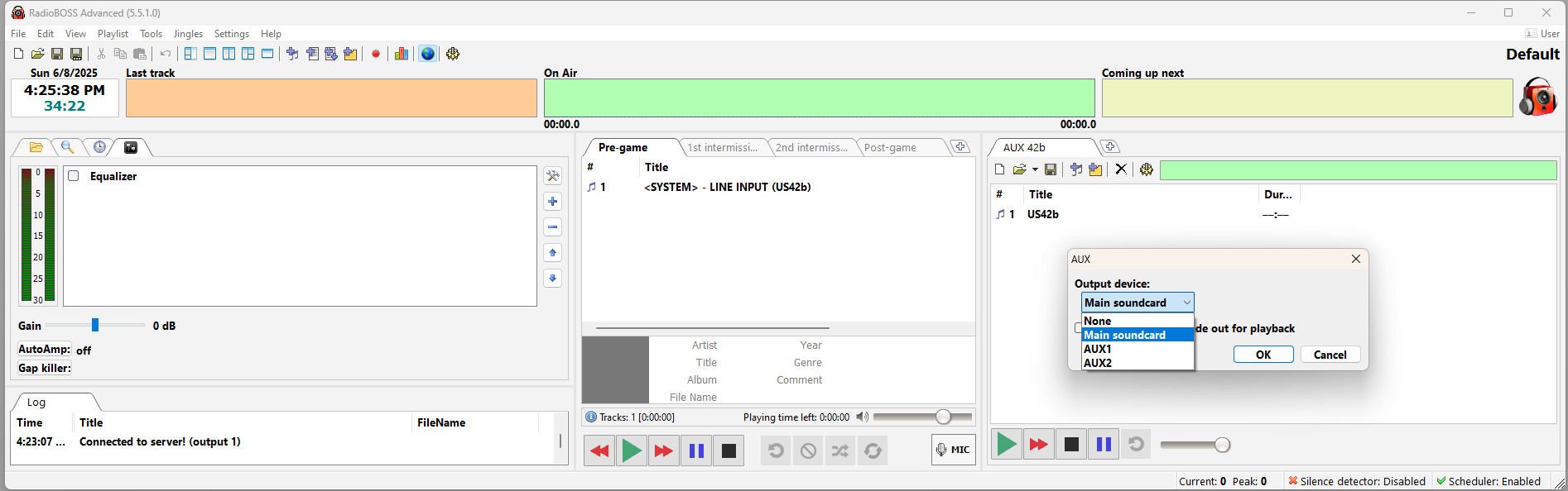

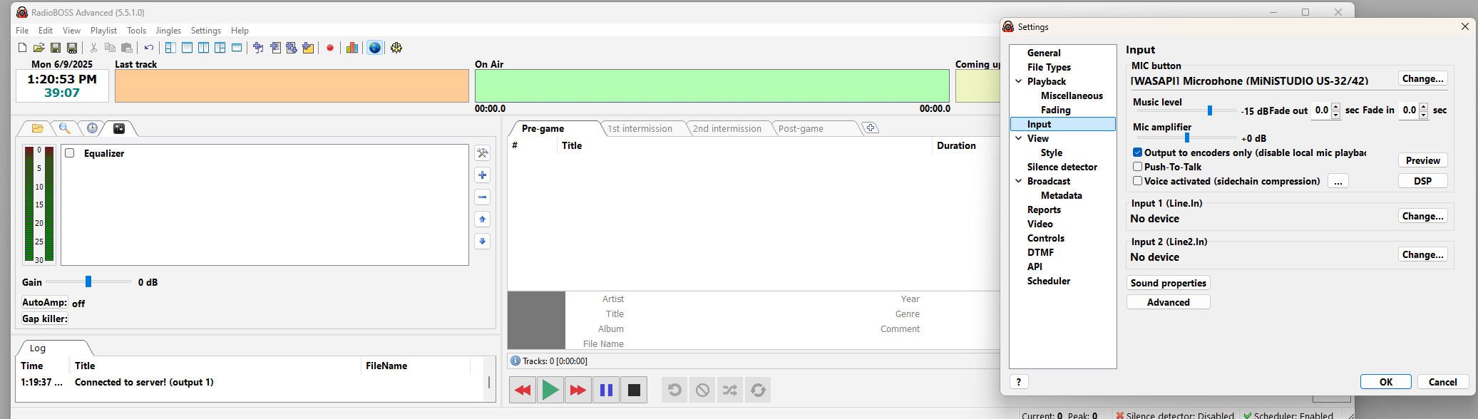

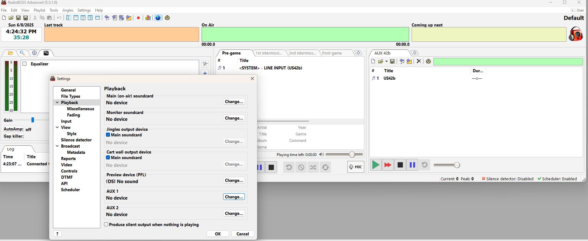

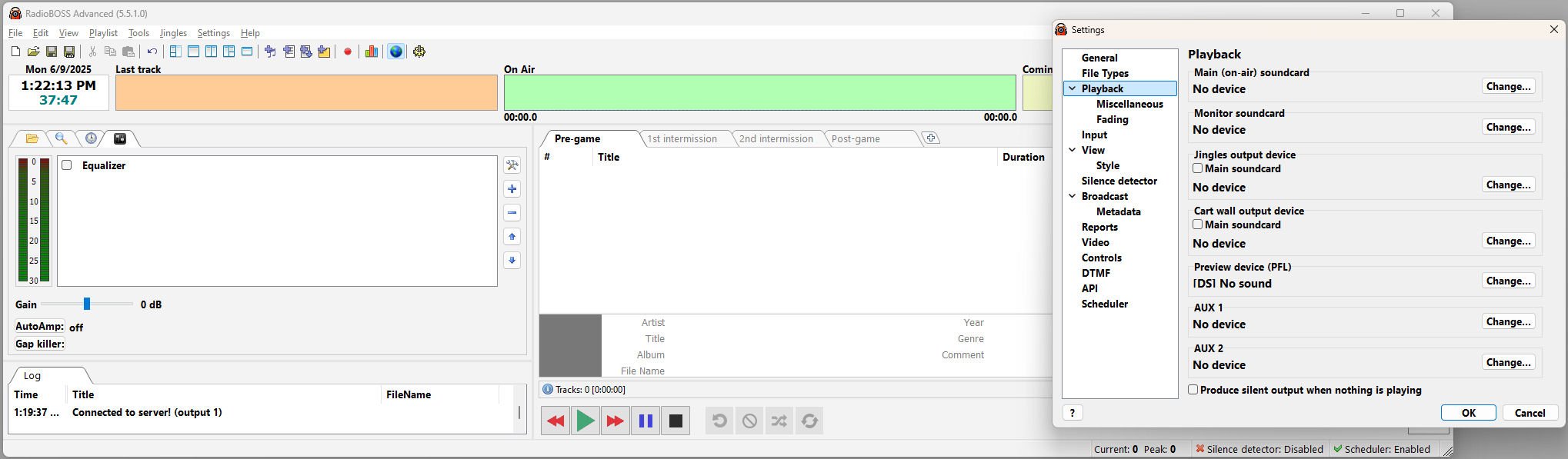

Would these settings be correct? If so, I'm getting a nasty echo through the headset mic, and while the sound pads initially came through with the mic switch off (don't seem to know), the file was also victim to echo.
Again, I'm as raw a rookie as possible -- and thanks again!
From the screenshot, looks like you're playing the line input from both the main playlist and AUX playlist - this is why it's echoing. You should stop one of those.

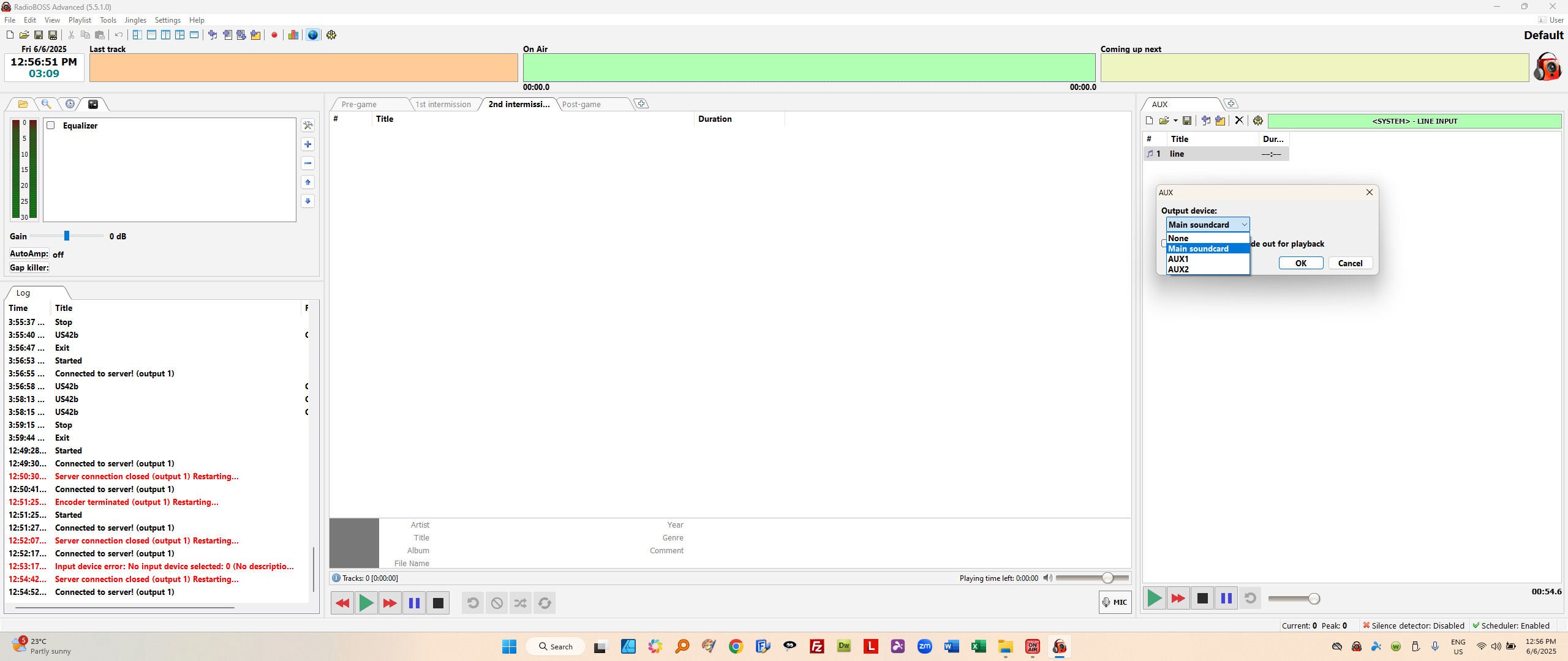

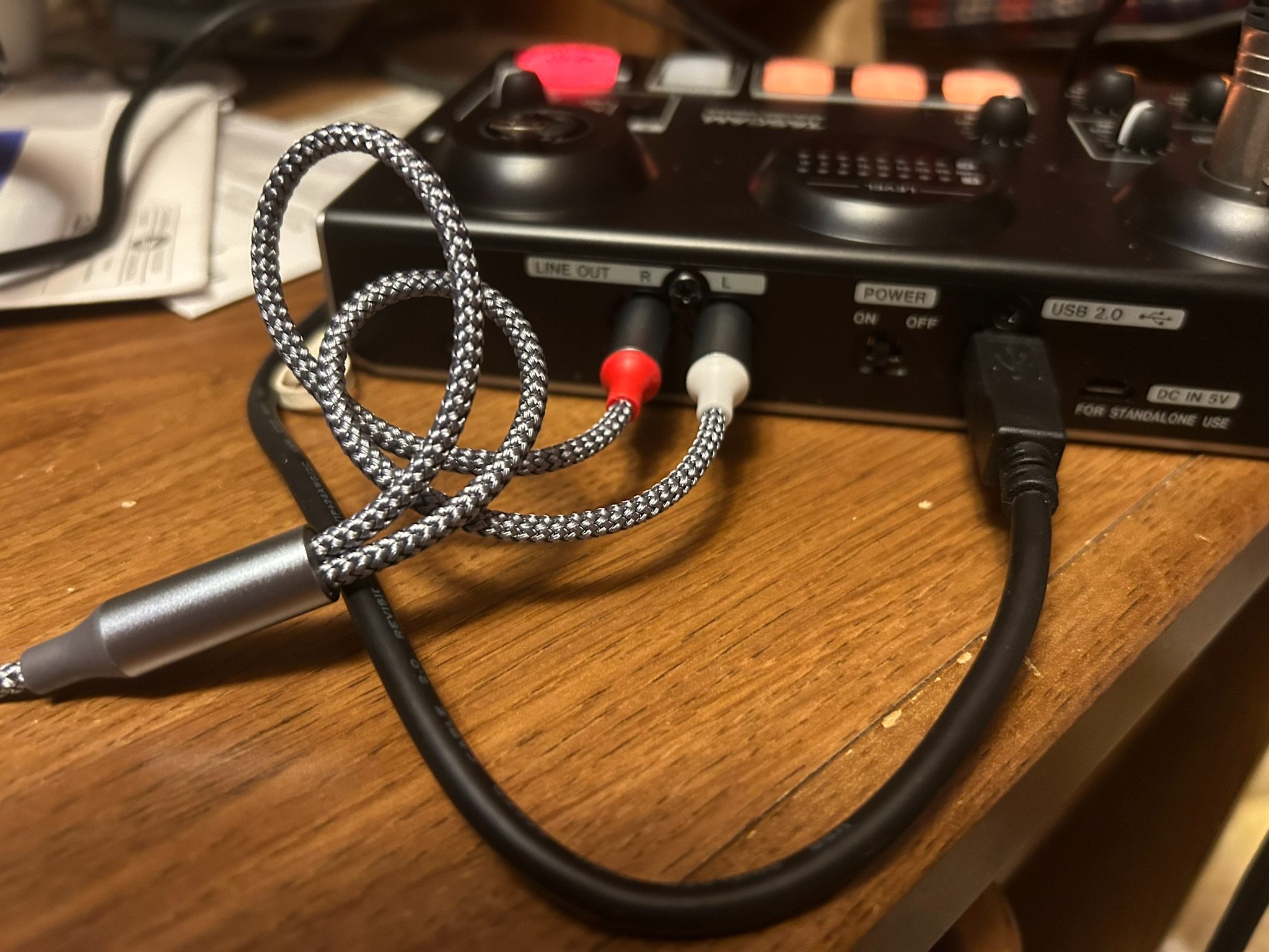

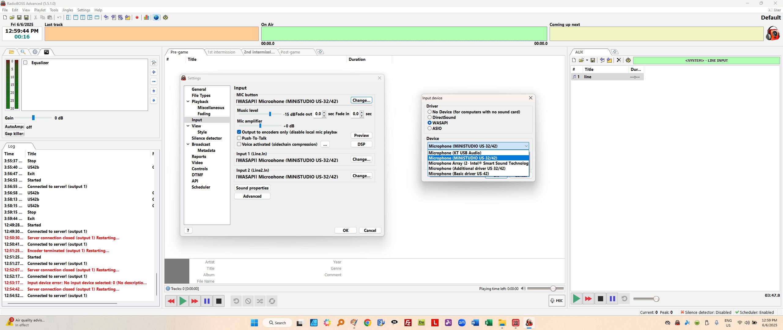

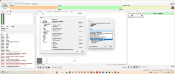

I'm obviously doing something wrong -- newbie woes. Here is my setup (US42b is hooked into the laptop but still not getting audio from the sound pads into RadioBOSS, either with mic switch on or off).
I really appreciate your help with this!

It seems to be working previously (where you did have an echo) - what changed? One possibility is that you have muted the sound on the mixer or somewhere else.

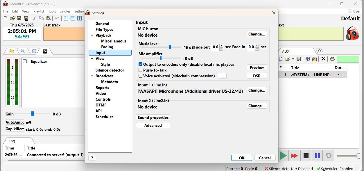

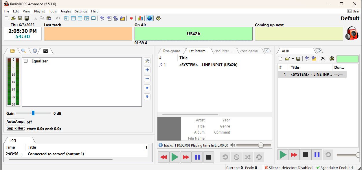

Thanks! When I was getting the echo, both my mic and a file from the sound pads were coming through the RadioBOSS meter, whether I had the mic switch on OR off. I muted the playback (these are my new settings) to get rid of the echo and I'm back to my original problem -- everything works fine when the mic switch is ON, nothing when it's OFF. I'm hoping to get the file from the sound pads coming through when the RadioBOSS mic switch is OFF. I'm either doing something wrong or it's not possible.
In this case, adding Line Input to AUX player and playing it there will be equivalent to having the MIC button pressed (if both input and MIC are configured to use the same device).

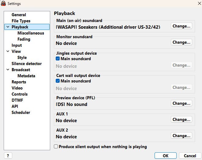

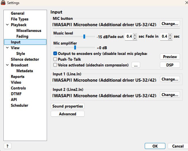

Well, I'm at wit's end. I've gone back to the most basic of settings -- mic input via US42b and no playback. Everything works with mic button ON, nothing with it OFF (which is what I expected).
When I add a line input, is "Main Soundcard" what I should click in options?

To test if the input works, you can add it to the main playlist and play it there. Then move it to AUX paylist, or keep it in the main playlist - depending on what end result you want to achieve.
When AUX player is set to play on the main device, it will play on the Main Soundcard you set in the settings - this is also where the main playlist plays.

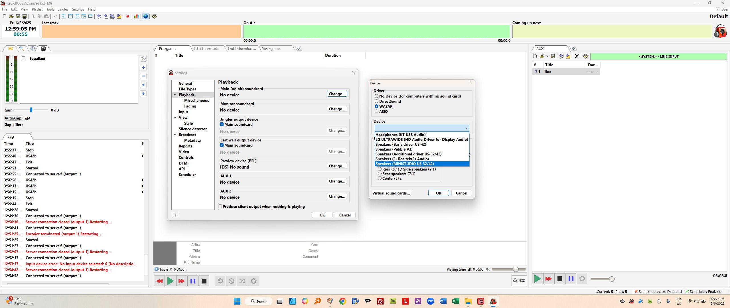

It was suggested by the TASCAM support people that I try ASIO settings in RadioBOSS to get separate feeds out of the US42b (mic and sound pad audio). There seem to be lots of options for playback and input, including an ASIO mixing driver. I can’t seem to get any sound into RadioBOSS, though. Is this doable or am I completely on the wrong track? Do I need something like ASIO4ALL or some third party software? Maybe an upgraded version of RadioBOSS (mine is 5.5). Apologies if these are dumb questions and — again — thanks so much for your help!
Generally you won't need ASIO4ALL, and anyway using it will not really allow using ASIO capabilities in full.
If you choose the ASIO option, do you see your audio device there? If so, then it supports ASIO. And after selecting the device, you need to choose proper ASIO channels for input/output in RadioBOSS. Usually the channels themselves are configured in sound card's control panel (you set what each channel is used for, its level and other options).
Thank you. The settings look to be right but I still get nothing via ASIO. I suspect it may be that the TASCAM US42b just doesn’t play well with RadioBOSS. I think I’ll start looking for another product that works with RB.

ASIO is a standard, so if a device supports ASIO, it will work with RadioBOSS too. I suppose the problem is with sound card's configuration. With ASIO devices you usually need to configure channels in sound card's settings, set their levels and purpose (in/out), and there are other options.
