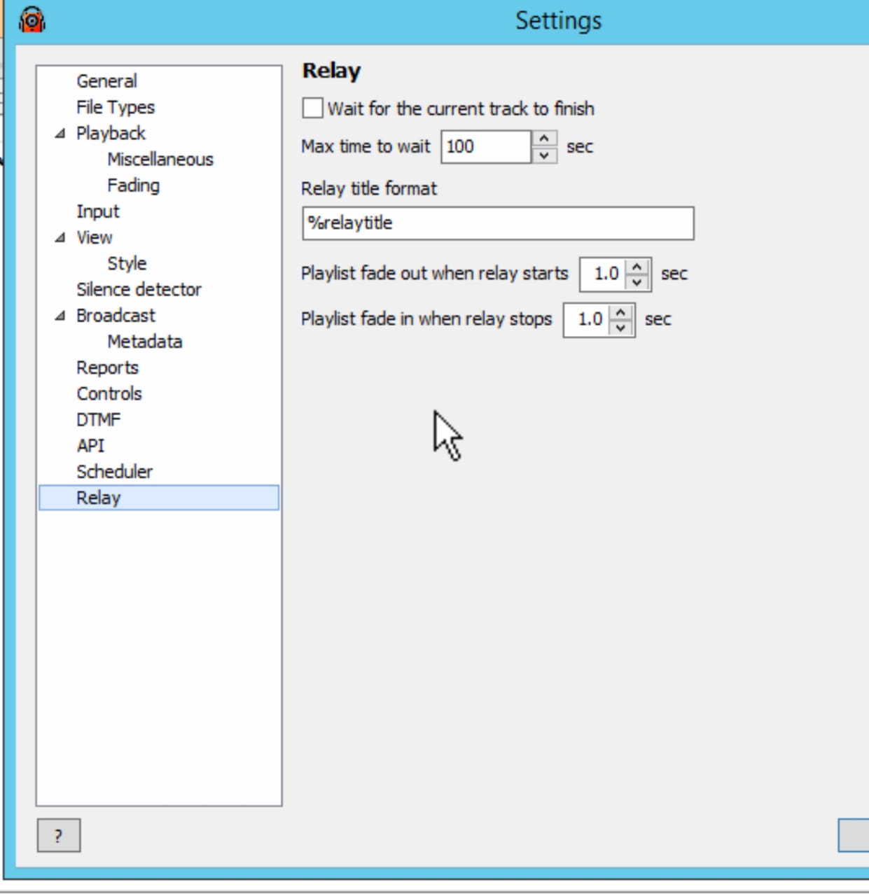

I have two mountpoints in my stream.
The frist one stream from radioBOSS playlists. And it is relaying the second mountpoint.
The second mountpoint I keep it for live streams only. Because my live streams are remote from the main stream.
Every thing work fine when I start live in the second stream, the first one will connect to the live.
But the problem is when I close the live stream, the relay is disconnect for some seconds and then reconnect while the live stream is off for few seconds then disconnect again and again.
I need your support to solve this issue as soon as possible.

Please open settings, Relay category and disable the "Wait for the current song to finish" option. It appears to not work correctly in some cases.
In this case, it should stay disconnected. Please try adding relayed stream to RadioBOSS playlist and play it (when it's not active) - does it show an error message?
Jamal3f said:
Shoutcast, and I tried more than one Shoutcast
It should work with Shoutcast... Can you please send the stream address to support@djsoft.net so we test it here?
