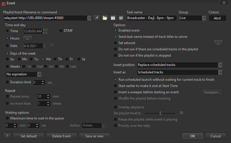

This is a sample of the settings i use. On another i was using the duration limit
The relaystart command doesn't support specifying duration via #nnnn - so this should be removed (in the future we'll add this possibility), also, setting the Duration Limit will not work either, as it's for the items that are playing in the playlist or overlay, while relaystart is a command and duration limit can't be applied there.
