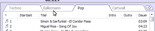

Have two questions because the playlists (as in the screenshot).
1. Can i activate the playlists with scheduler? so i will start playlist pop at e.g. 12p.m.?
2. If i have more playlists, like me tchno, ballermann, pop,... how can i see, which is currently playing?
Could e.g. the name of the active playlist display in a different color?
Thanks :)
Hi,
1. No, scheduler can not activate playlists.
2. To know what playlist is playing, click on the green Now playing bar and it will switch to the active playlist.
When those playlist tabs were added (couple of years ago), active playlist tab was marked in bold. But later that was removed... I don't remember why :)
