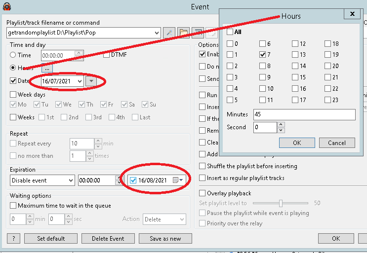

I tried like this attachment pictures, but the playlist doesn't respond and doesn't go to the Radioboss playlist
I mean to make a schedule from 16-7-2021 to 16-8-2021
This is an example of a palylist entering every 7.45 am but it doesn't work, if it works I will make a checklist of 7.45, 12.45, 19.45

Click the Run Now button works fine, the incoming playlist is added to the radioboss playlist
but the schedule doesn't work (the playlist doesn't add to the radioboss playlist), please see the picture I sent above, is there something wrong?
it turns out that the problem is still having to set the day, so that it can run properly.

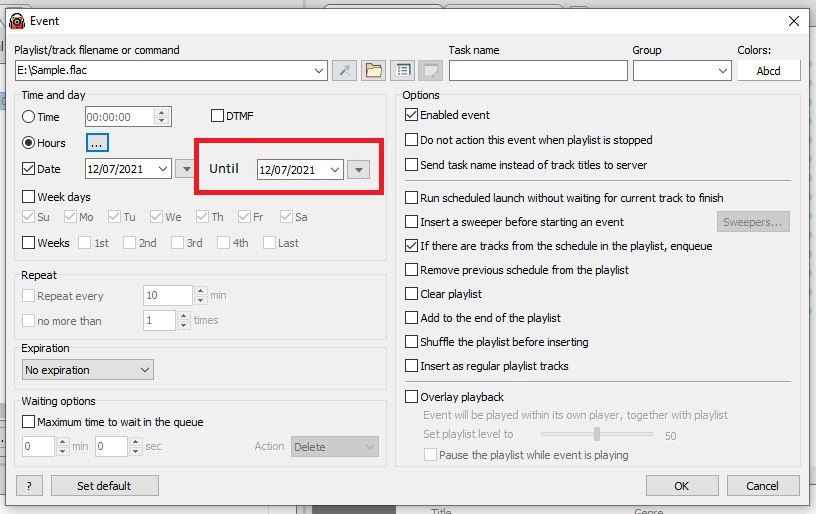

in other radio automatic software only specify the start date and end date hahahaha...
Setting the date is not required. How the date option works is explained here: https://manual.djsoft.net/radioboss/en/scheduler_options.htm
yes i understand that, but i mean setting for a future date in a certain time range. That's why I set the date. so basically the date range setting in radioBOSS must also be set on the day, that's the main difference with other software. if in other software you can only enter the date: from date .... to date ... (no need to set the day), thank's
