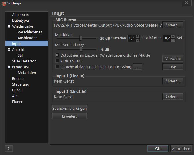

More information is needed on your configuration, maybe we'll find some solution.
Generally, I think you need to route RadioBOSS playback to the virtual card to mix it with speech in Voicemeeter - you can use the "Monitor soundcard" in RadioBOSS Settings->Playback to do that.

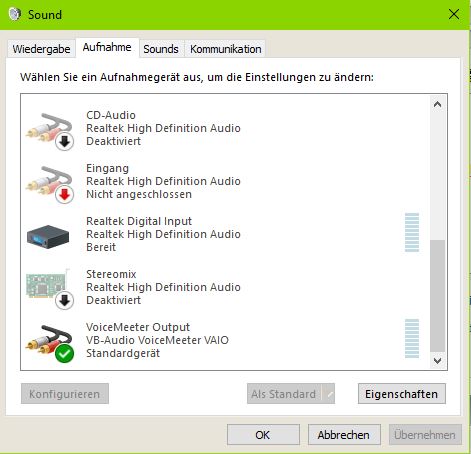

Hi Dmitriy,
thank you for your response. My current configuration you'll see in the attachments.
If you don't have another suggestion I will test the monitor option within the next days.

I think you need to select virtual audio card in Skype as input device - it should have both microphone and music there. But I'm not sure as I'm not familiar with how Voicemeeter works.
