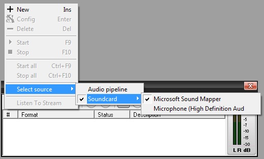

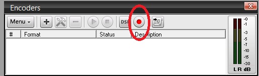

I have this problem too.  [edit] have solved this problem very nice (screenshot). You can choose what you want to boradcast - that what you do with program, or all what comes to soundcard.
This is really nice way to solve the problem and work with external mixer. Hope this feature will be added to radioboss too.

Yes, this will be added in the next version.
Currently you can use RadioCaster to broadcast sound card playback.
