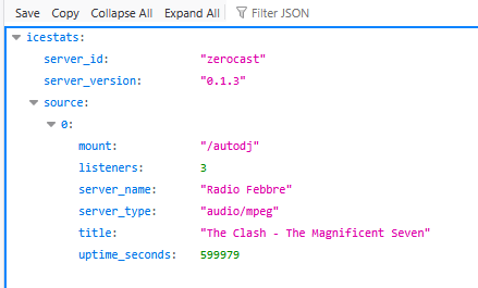

Regarding the statistics issue, I have conducted further investigation. While the API endpoints for listener data appear to be backward-compatible with Icecast, there seems to be a discrepancy in the date format returned by the server.
I am forwarding this information to both you and the Streaming Statistics development team, in the hope that it helps identify the root cause of the compatibility issue. The error consistently triggered is:
"0x80131537: Stringa non riconosciuta come valore DateTime valido" (String was not recognized as a valid DateTime).
It appears that the application is struggling to parse the date/time string from the current API output. Please let me know if you need any additional logs or technical details from my side to help resolve this.
The /admin/listclients?mount=... API is not supposed to return any date/time values, so it seems they call /admin/stats and parse some field with date/time string. Zerocast does not offer any date fields in this API call result. Some Icecast versions do, e.g., stream start date, or server start date. This information doesn't seem very useful, so I suppose the service you use should just ignore if those fields are not present or empty.
If there are some useful date/time fields that help with statistics, we can add those of course.
