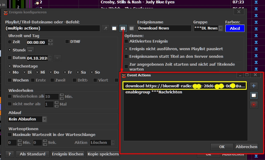

I also had this problem with the Laut.fm news
I first had to create an MP3 file in the folder with the name of the message file you specified in the events and give this file all rights
The command in the event:
download https: // bluewolf-radio: xxx-28d6-xxx-0d11@api.radioadmin.laut.fm/news/1 C: \ Program Files \ RadioBOSS \ Nachrichten \ Nachrichten.mp3
