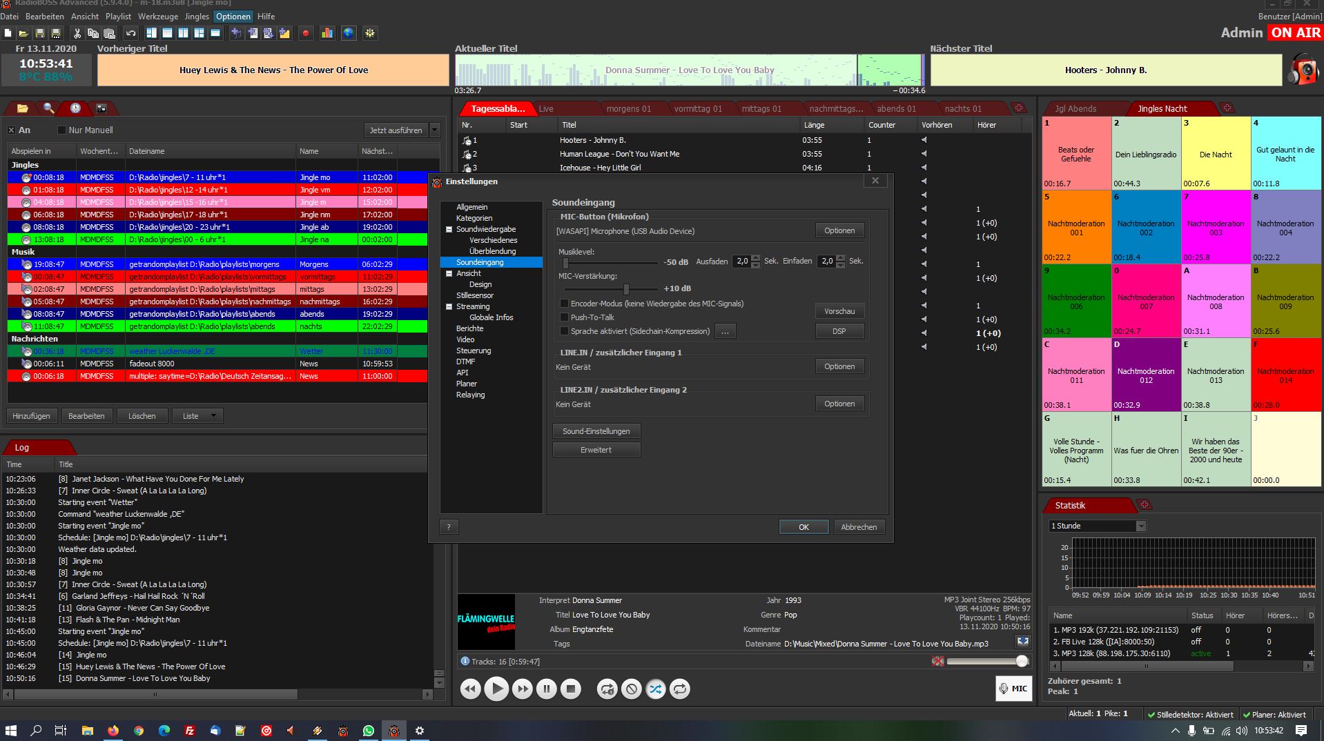

I am trying to use the micerophone option in Radioboss. In the manual it says i have to set the music level to -50dB for complete silence of the music using the mic button.
now I still hear the music in the background. Its not loud but still... I do not want to hear the music when using the microphone.
Do I do something wrong?
Your configuration is correct, and testing it on RadioBOSS 5.9 and 6.0 seems to be working, the music is muted completely when the level is set to -50dB. You can try restarting RadioBOSS to see if it helps.
