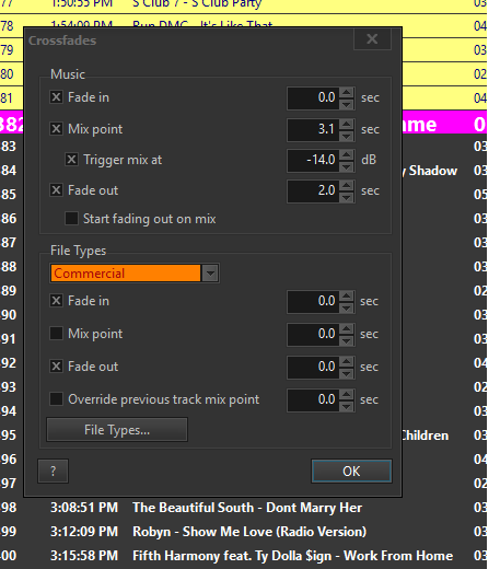

I have noticed that each song plays in the first 30 seconds on a lower volume and then slowly goes to the normal level.
Did the update change anything in this area because our settings never changed.
Please check your crossfade settings, it appears that you have long Fade In: http://manual.djsoft.net/radioboss/en/crossfades.htm
There was nothing changed in the update - if a bug such as this existed, then we'd have tons of support emails about it :)
Your crossfade settings are fine. The problem is somewhere else - please check what DSPs and plugins you use (try disabling everything).It can also be some setting in the sound card that makes it work like this.
