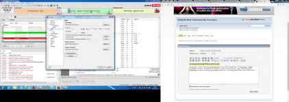

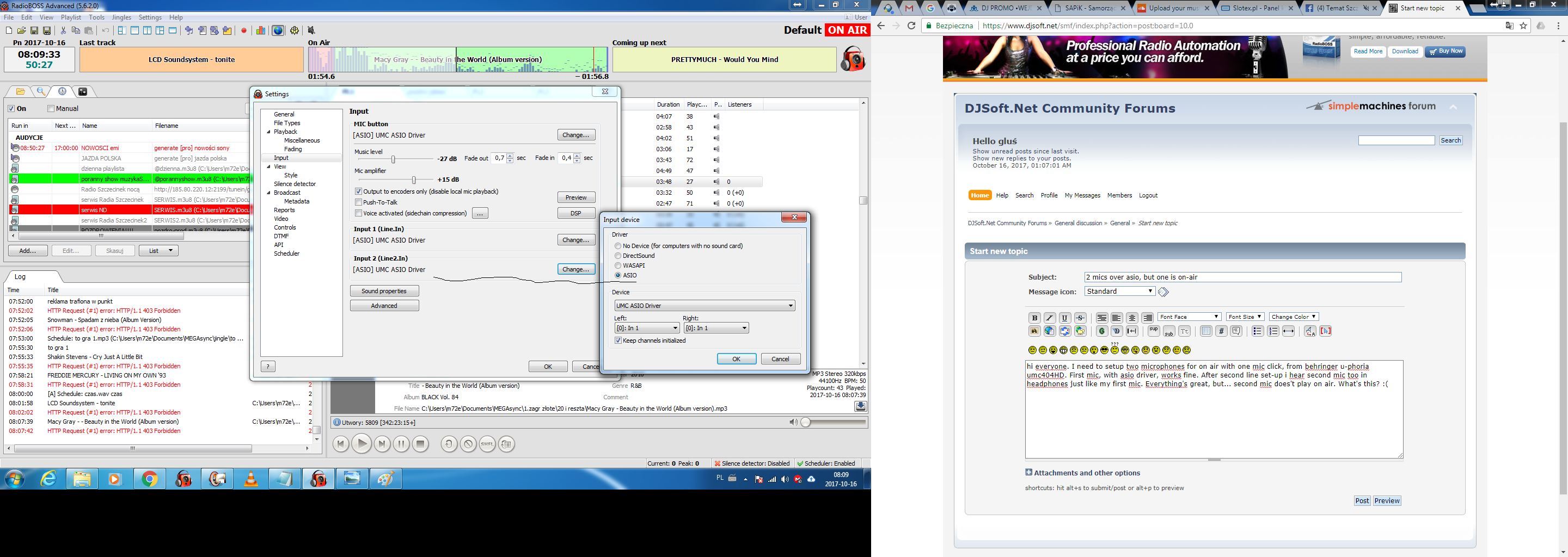

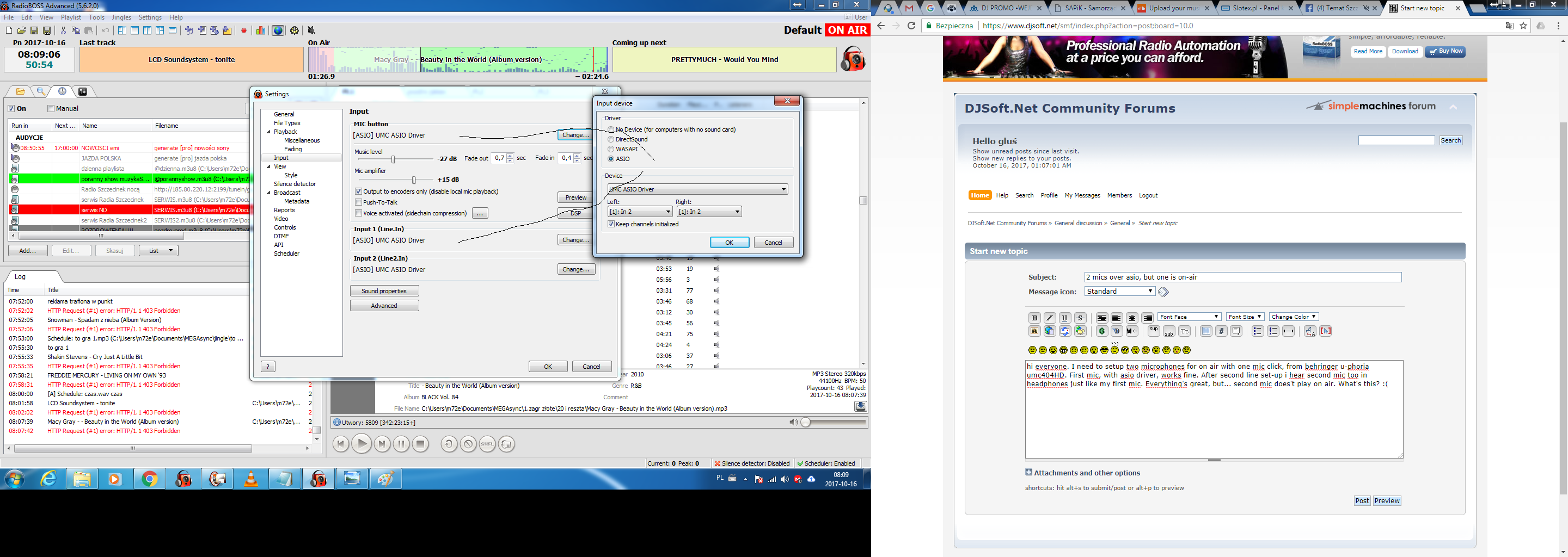

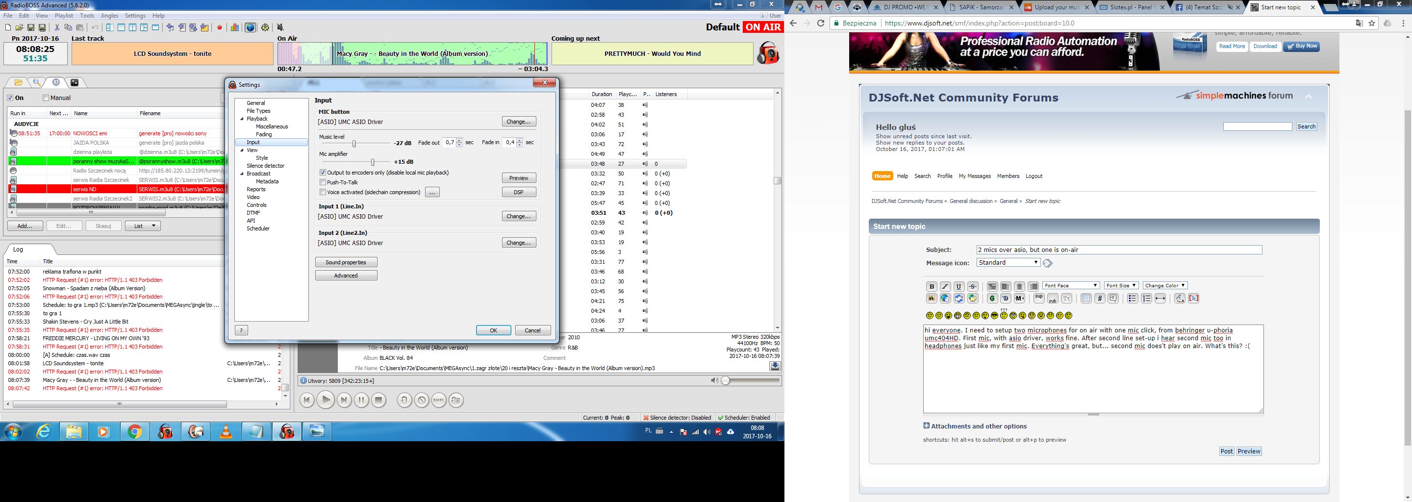

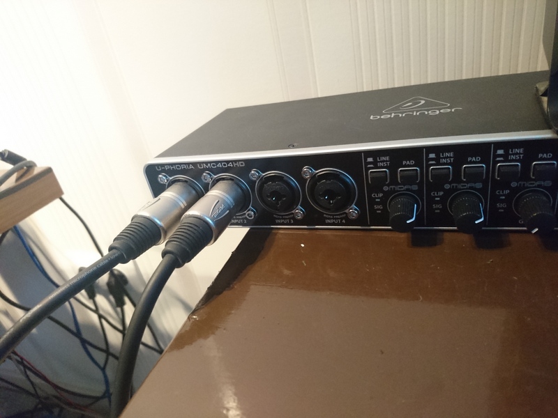

hi everyone. I need to setup two microphones for on air with one mic click, from behringer u-phoria umc404HD. First mic, with asio driver, works fine. After second line set-up i hear second mic too in headphones just like my first mic. Everything's great, but... second mic does't play on air. What's this? :(

When you press the MIC button, it only activates the input that's selected for the "MIC Button". "Input 1" and "Input 2" are not activated by the MIC button (those are used for other purposes).
Usually devices like yours offer hardware and/or software option to mix the two inputs into one. You should do such a mixing, and select the mixed channel as input for mic button.
