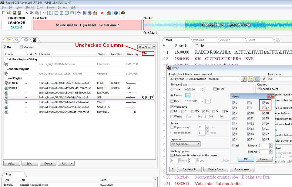

Radio stations which work with Hours Event would like to have an allert option when an hour is unchecked in Hours.
Sometimes wee need to expand program and have two or three merged hours.
But next week things go normal so it is possible to forget to check all hours.
In fact we forgot a lot of time to check unchecked hours...

First of all we know how to use Event Hours.
Sometimes we start at 16:00 with a rebroadcasting by 10 minutes (CNN, BBC, Whatever).
Then an ID Station and commercials.
One music track or two,
Followed by a program which has 55 minutes.
It is obviously that we have to merge 16 and 17 hour.
That means that we must uncheck 17 hour in Event.
It is unproductive to check all the time hours. And sometimes we forget to do that.
That's why an option to alert us will be great:
Something like:
This looks good, although it would make more sense to show checked hours in the column, not unchecked.
Still, what cost you to make a loop to display unchecked?
In options area anyone can choose between
  • |_| checked
  • |x| unchecked
The problem with such situation-specific options, is that is all of them are added, the software will be bloated. Imagine a list of thousands options, it's totally unmanageable.
