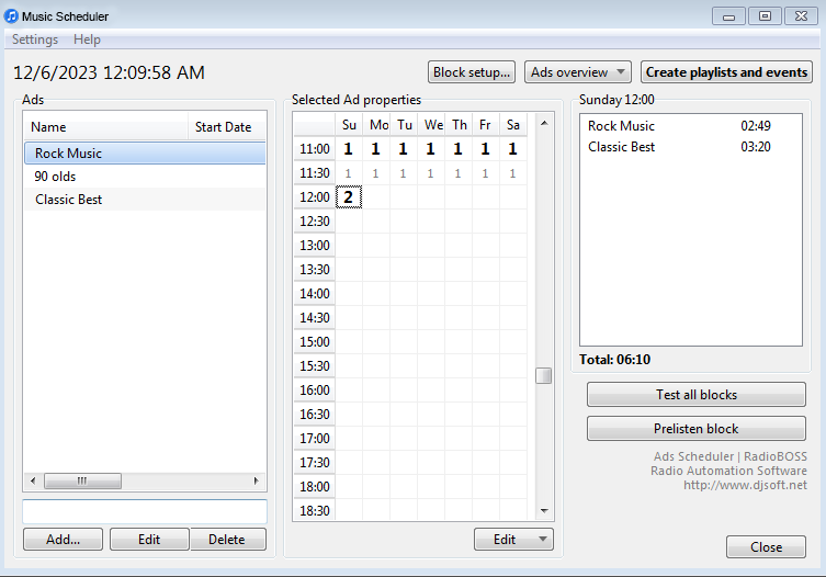

One possibility I see for this to be added - in a form similar to Ads Scheduler, a module may be called like Clock Wheel Planner, where you configure a "wheel", and based on it, it generates the necessary scheduled events automatically.

do you mean something like this? :cool:
Not quite, I think it can be implemented as an actual "wheel" where events can added somehow. We'll need to test various approaches for this.

I guess it'll allow selecting day of the week and will show a "wheel" (a 24 sectors circle / a grid / whatever) for each hour of the day. Something like this. We'd need to start with something then we'll see where to move on.

That's what the new module "Clock Wheel Rotation" (or whatever it'll be called) is supposed to do.

The new module will be a tool similar to Ads Scheduler - it will create and manage scheduled events, the idea is to make it easy to create multiple similar events.
