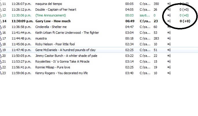

I have a problem with the column that shows the listeners. It turns out that it always shows zero (0), even if there are listeners. I do not know if I misfired something. The bad thing is that it appears in the reports. Thanks for the help.
I upload a sample photo

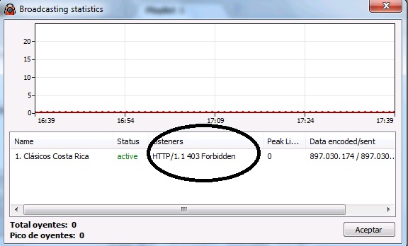

This is the error that you see in the statistics
The error message means the stats can't be retrieves from the server. What streaming server do you use, and how statistcis are configured in RadioBOSS - do you use Statistic Relays?

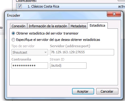

I use Shoutcast, getting server statistics, a week ago it worked. I changed the configuration of the statistics according to the link that you put to Jens, but it does not work, probably because it can only be used with Icecast.
Will those of us who use Shoutcast lose options?
The version of RadioBoss that I use is 5.6.0.7

This works with Shoutcast as well. The exact configuration depends on the server you use. Typically, you will need to put the administrator password in the password field (this is different from password used for streaming) and leave the Station ID empty.
