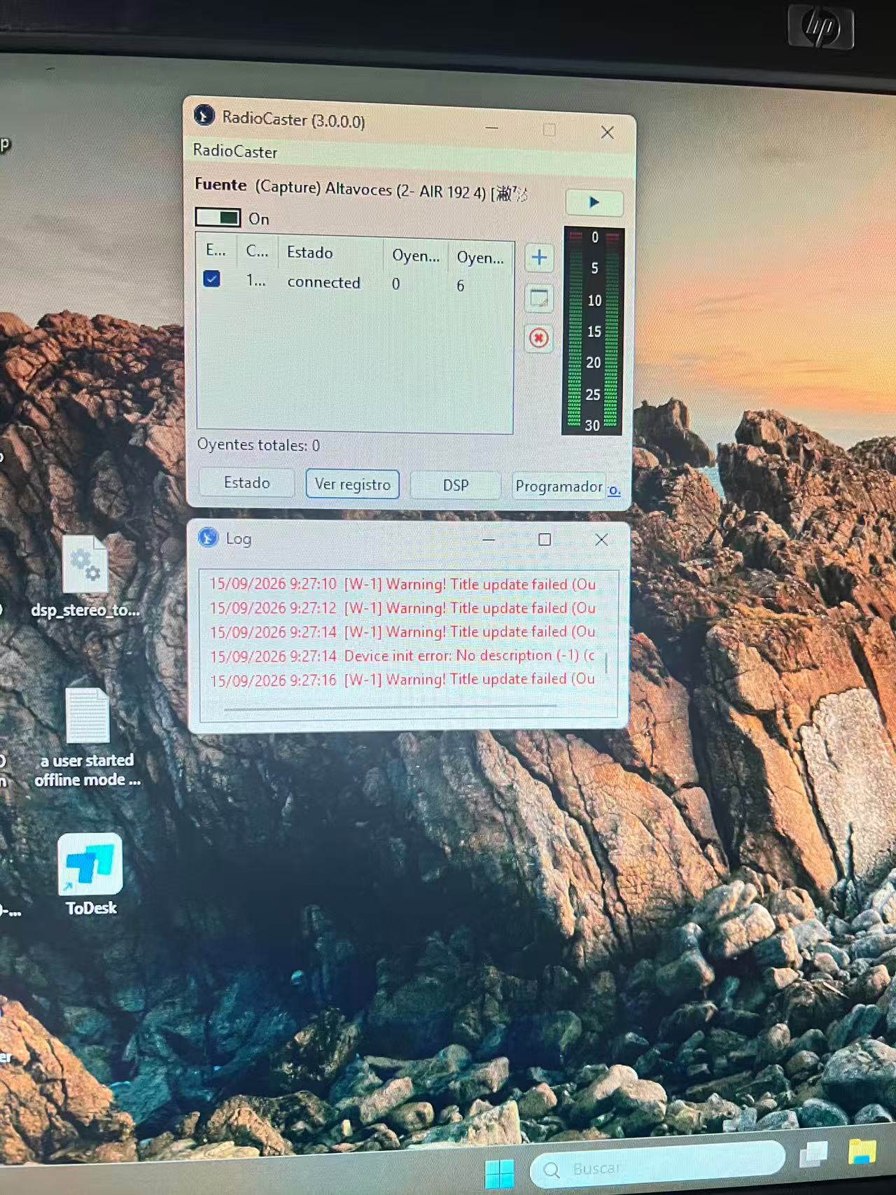

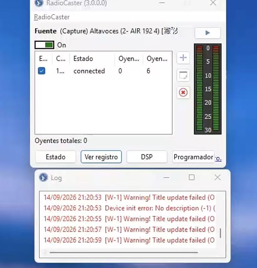

RadioCaster 会随机抛出以下错误:设备初始化错误:无描述 (-1)。一旦出现此错误,音频波形就会冻结,我们的广播流也会停止。这种情况几乎每天都会发生。目前,我们必须重启 RadioCaster 甚至整个计算机才能恢复广播流,但这对于我们不间断的广播服务来说是无法接受的。

From the error messages on screenshots, it looks like the server does not accept title updates. You can try changing the encoding in the encoder settings, on Metadata tab. You should also check the server logs to see why it doesn't accept the titles.

Thanks. I understand that the “Title update failed” messages may be related to metadata encoding or the streaming server.
However, our main issue is that RadioCaster periodically shows “Device init error: No description (-1)”. At the same time, the audio level meter freezes and the stream stops sending audio, while Jazler continues playing locally.
Could this error be related to the audio capture device or sound card initialization rather than metadata?
It means that RadioCaster had detected device failure; it did not cause that failure, and can't really do anything about it, except to try re-init the device. It does this once, and if that fails, the device is considered failed.
What you an try is to use a different sound device.
