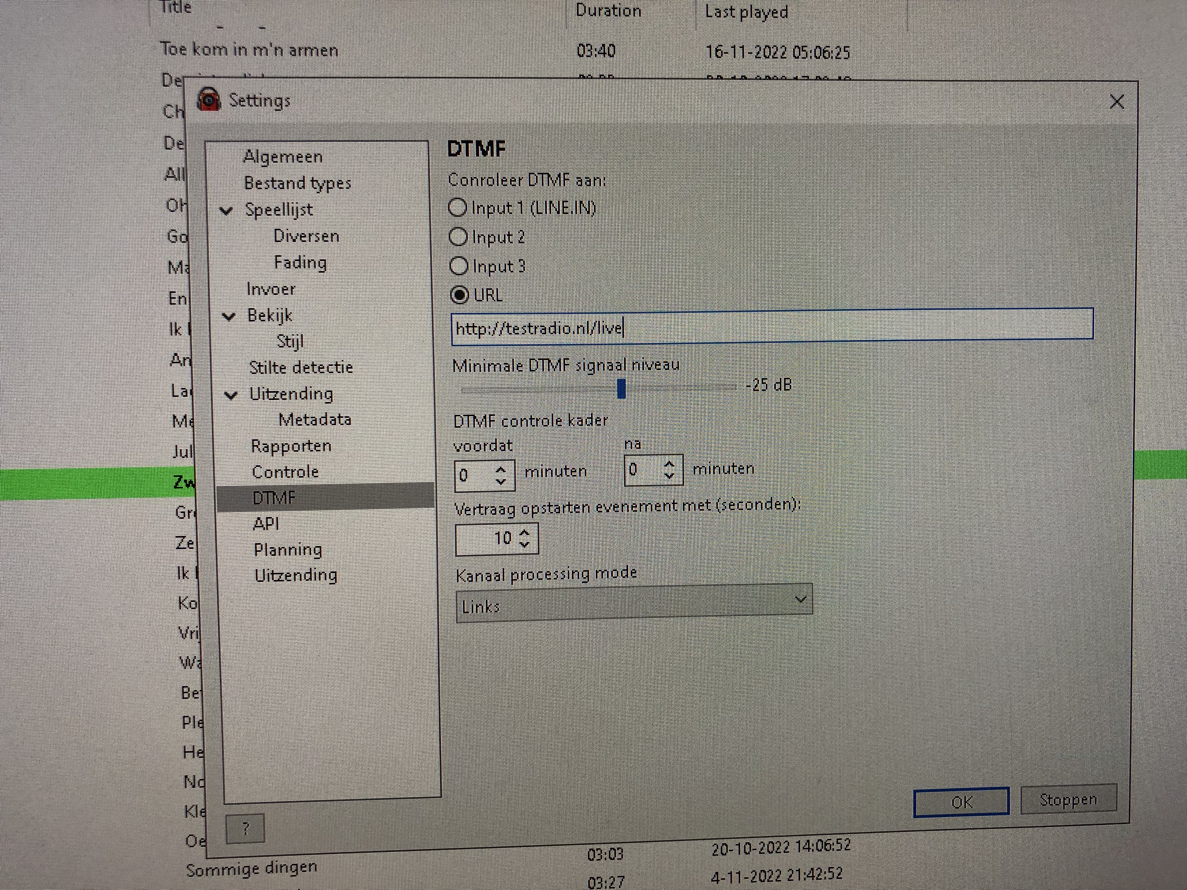

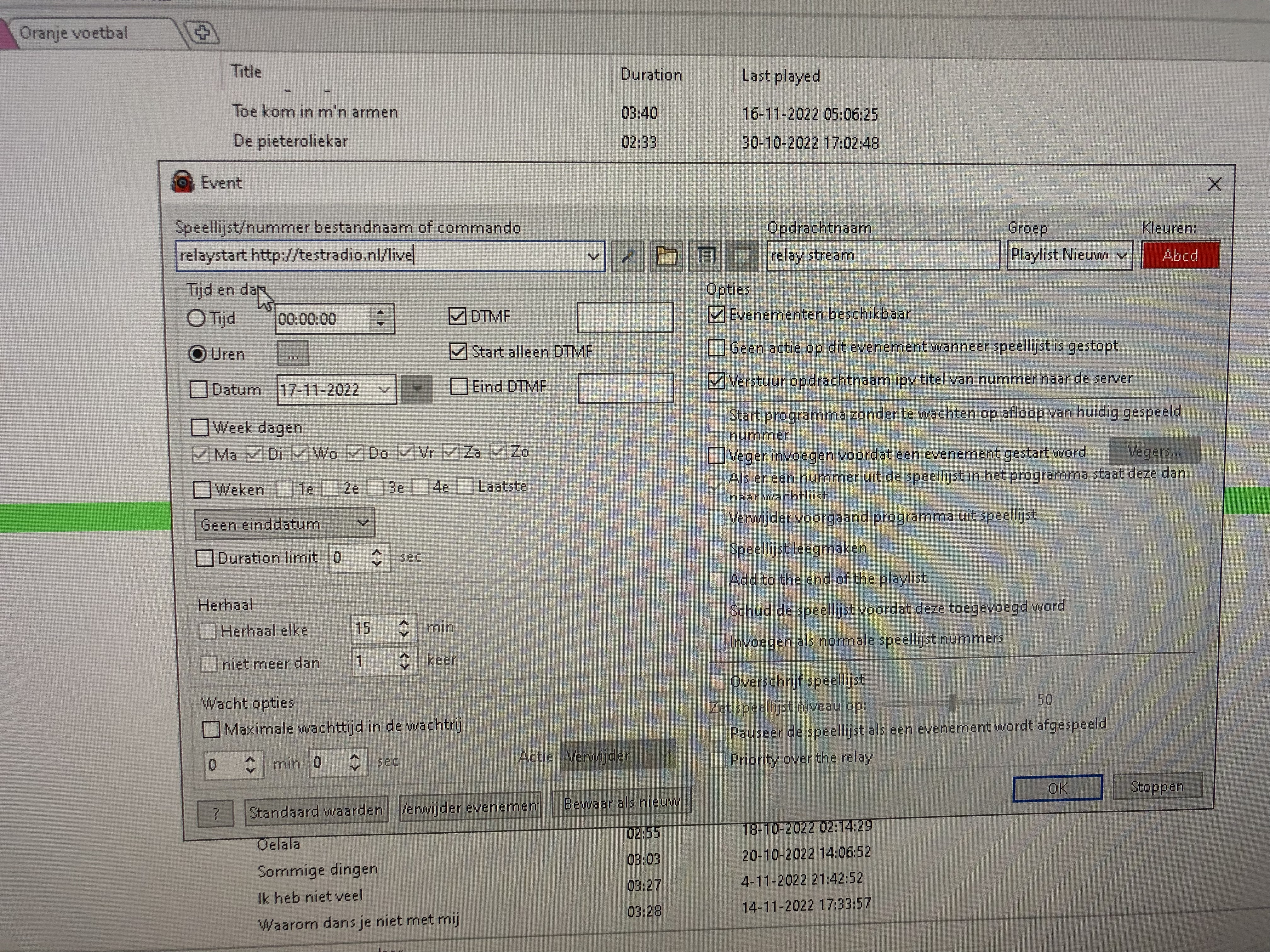

Hi Djsoft,
I have now this settings.
I want the live stream to play automatically when the stream is on air. But nothing happens unless I activate it manually.
//Kevin is

If I use the repeat function every 1 min.
Will he reload the stream every minute.
Can't it just be unlimited like icecast for example fallback.
Just straight away
When the relay is started, it will start playing the stream when it's available - this is automatic.
You shouldn't repeat the relaystart event - once started, it stays active until it's stopped with the relaystop command.
