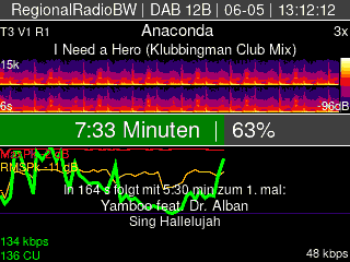

A new variable like the existing "%len". But for the real lenght, because if the gap killer is activated, the track is shorter than the original.
So, "%reallen" for example. Nearly every track is shorter than the original and I use the "%len" for a progress bar. See the screenshot of the DAB radio display. This progress ends often at 95% or 97%. Not really perfect. So, how is the effort? The gap killer should know in the first second the real track lenght. And if you send after the first second the broadcast title format, then the information is valid.
I use at the moment this config:
%artist;%title;%filename;%playcount;%len;%seconds~
The result is processed in the DAB Mux and a PNG is generated for the digital radio and the send every 6 seconds.

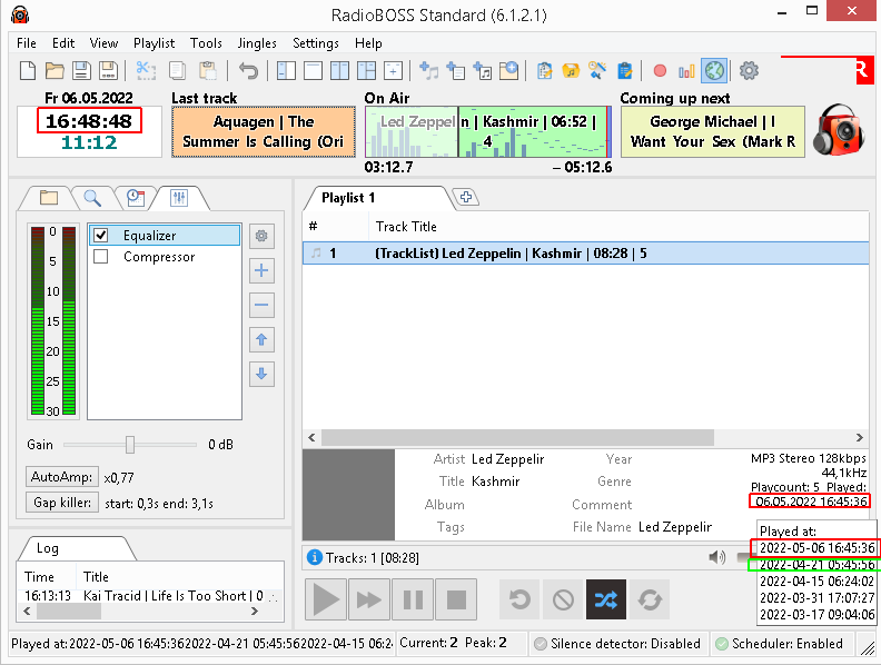

Typicall the lastplayed date is after the first second of a tile the actual date and time. Nice, but I need the real last played time, not the latest played
Do you mean previously played date/time?
The actual time (Red) is well known during playing the title and also displayed under the playcount. Does this really makes sense to show this here? Because it is better to see the real last / previous play. Stations often play titles several times a day, because a new moderator doesn't know the previous playout. Only in the database.
To answer your question: Thanks if there is an access to the previous time, marked here in Green.

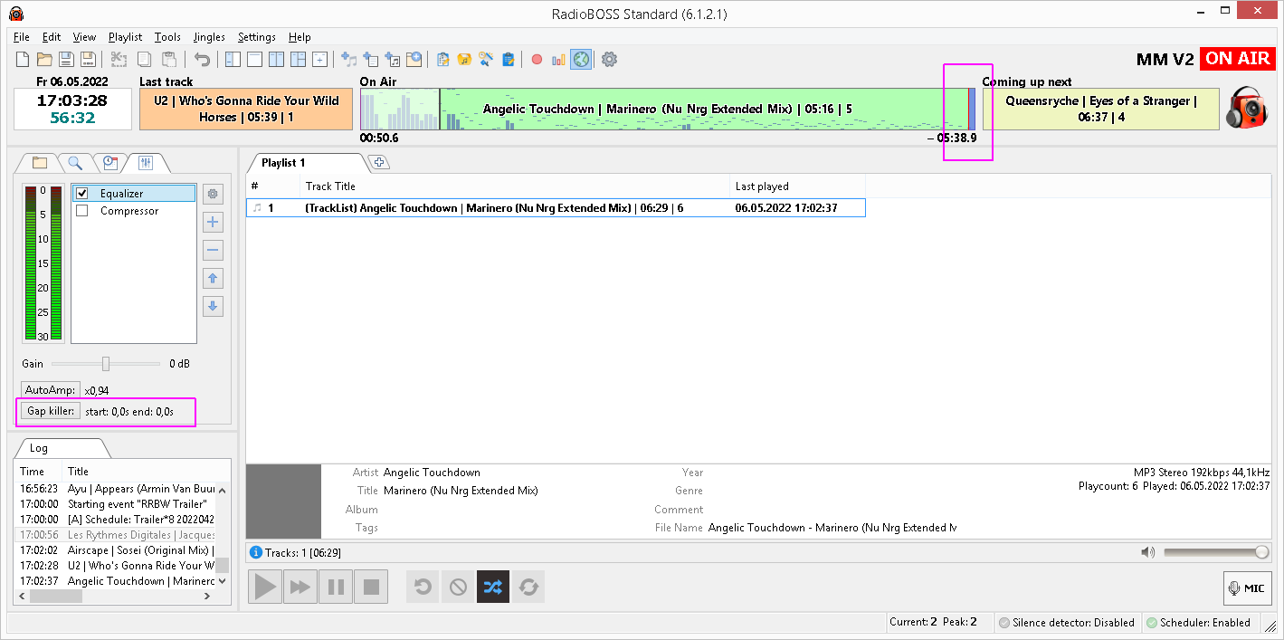

Regarding the active / real title play time, I'm not sure if this is the track time minus gap killer. What I mean is the blue field at the end of the track here, because gap killer sets itself to 0 for this title. So there is another feature who did a gap. See market
parts.
Yes, makes sense, I've added it for the upcoming RadioBOSS 6.2.
The actual playback time = total track duration - gap killer - mix point.
I forgot the mix-point. It makes sence to get all 3 timings into account. Thanks for your quick response. I'll wait for the next release to check that new variable!
