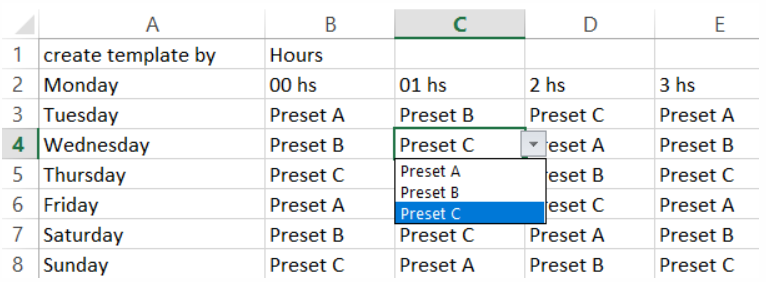

The problem is when we want a simple way to set each hour of the week. 168 events is not an easy thing to configure. There will be many errors, changing the rotation is not easy.
One of the things we did was use a different preset for the same time depending on the day of the week. So on Monday at 3:00 p.m., it will not have the same rotation as on Tuesday at 3:00 p.m., etc.
You can see it in the ids of this image.
Doing this manually is very difficult to maintain. An assistant would be very useful. (Which then ends up generating all the necessary events in this case 168)
hours per day of the week:
I think this will be possible to add, Playlist Generator is already able to create events in RadioBOSS, it just needs to be extended to allow managing hours for presets and creating events with "multiple start time" option.

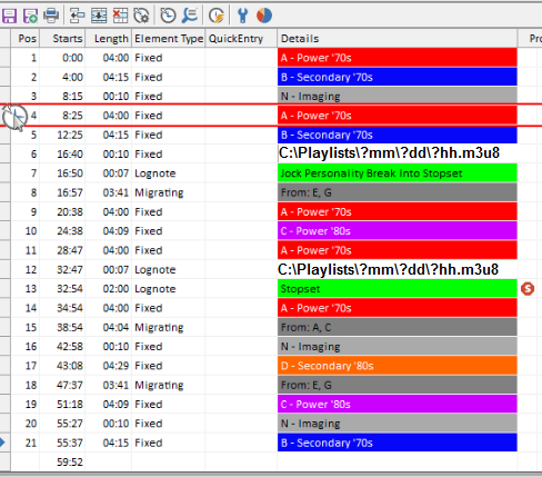

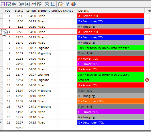

I haven't tried that yet, but you can for sure in MusicMaster.
There are special categories for inserting automator commands, just like in this image.
