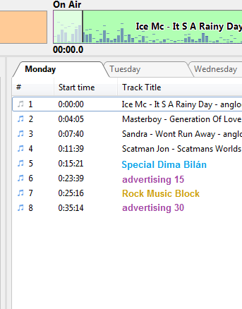

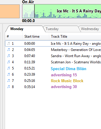

My idea is something like this.
The idea is to go to each hour of the day easily without the need to scroll
Yes, looks like a good way, to add it to playlist tabs, and allow to show/hide it. Added it to the list for new updates, thank you.

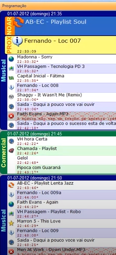

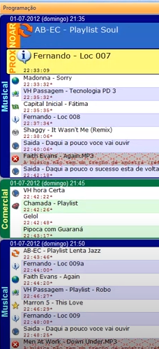

We have an idea of changing playlist to a Tree structure, where started events will appear as an expanded tree item, making event bounds more obvious.
tree structure? Is it something like this?
I recently found this program "playlist digital"
Everything is managed from a "single list", where the daily schedule appears.
it also has the same pause and stop commands as RB.
this could be a way to carry a more fluid programming in RB.
Obviously with their differences and in the style of RB.
I would like to know what everyone thinks.
