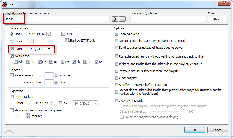

One of the possible solutions:
Create a schedule event which will never run (eg. set its date in the far future). The event will insert Line.In and that Line.In will be automatically deleted after playback.
When you need to insert Line.in, select this event in the Events list and click Run Now.

You don't need timing at all - the only purpose to have an event is to automatically delete Line.In from the playlist.
First picture has an example event attached - note that "Run scheduled launch without waiting" is off and the event has startup date somewhere in year 2099.

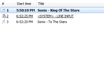

When you select this event in the list and click Run Now, a Line.In entry will be added to the playlist - please see the second picture. As you see, line.in is inserted in the playlist and will be played after current track is finished.
After you play Line.In, it will be removed from the playlist and wouldn't cause you any trouble in the future.
