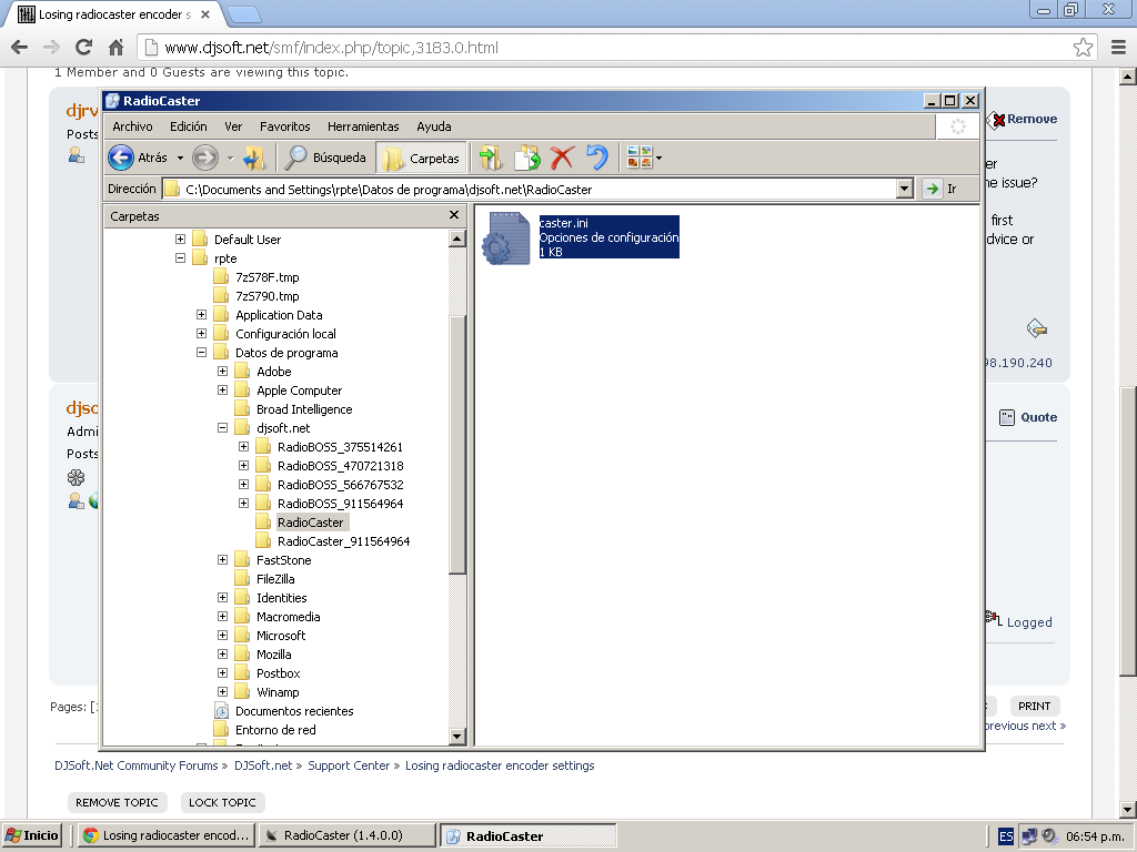

Last time this happened there was two folders on C:\Users\<UserName>\AppData\Roaming\djsoft.net\    one numbered and the other one without number, only radiocaster as name, as you can see in the picture I'm attaching you, radiocaster.png
The folder numbered had into it the file caster.ini which I'm attaching you and the folder without numeration had the file caster_empty.ini (I renamed to caster_empty.ini) its original name was caster.ini as you can see file caster_empty.ini doesn't have any settings recorded, I don't know how this happened.

"RadioCaster" folder without number is a settings folder from the older version. You can remove it.

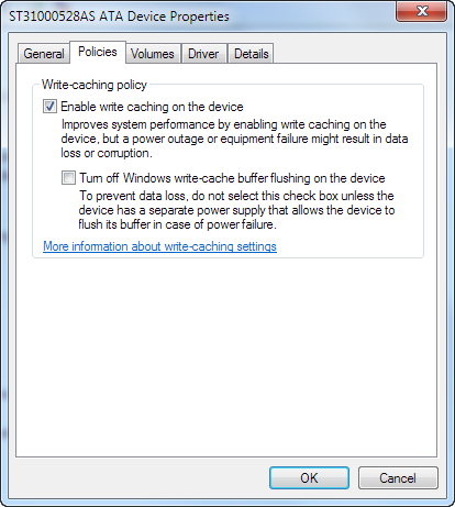

Windows caches data - not everything goes immediately to the disk, some data stays in cache, and if power suddenly is out or you reset the system, the data is not written to disk and lost.
Please see screenshot of a Windows drive properties (those are default settings). As you see, the caching is enabled and there's a warning about data loss. You can turn caching off, but better solution would be to use UPS.

As I said above, most likely the cause is Write-caching.
