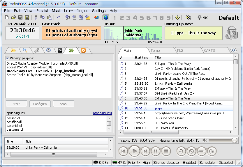

Played with this Breakaway Plugin, and it seems to be very easy to setup with RadioBOSS.
1) Download and install the Breakaway Live software: http://www.ceaudio.com/download/breakaway_live_setup_0.90.96.exe
2) Download Live Link DSP plugin: http://www.claessonedwards.com/dsp_plugins/dsp_livelink.zip
Extract archive contents to <RadioBOSS Dir>\Plugins\Winamp. (<RadioBOSS Dir> is folder where you have RadioBOSS installed, usually it's something like C:\Program Files (x86)\RadioBOSS).
3) In RadioBOSS open "Plugins" tab, check "Winamp Plugins" to turn Winamp plugins on, then the plugins list will be populated. Check the "Breakaway Live - Live Link1" and click "Start". The plugin name will became bold meaning the plugin started successfully. Please see the picture attached to see how it should look like.
4) Setup broadcasting in RadioBOSS. The signal sent to servers will be already processed by Breakaway plugin.

can you instruct me how all ins and outs we setup in the radioboss software, breakaway and your computer. I can not get it working and now have audio noise
tunnelvision said:
I am using breakaway Broadcaster not breakaway live, does this make a difference because it doesn't work :mad:
Yes. As you can see on this page: http://www.claessonedwards.com/index.php?option=com_content&view=article&id=80, there are two versions of Live Link plugins, one for "Live" and one for "Broadcast" version.
So, on Step 2 you should download this plugin: http://www.claessonedwards.com/dsp_plugins/dsp_livelink_bbp.zip and use it instead.
