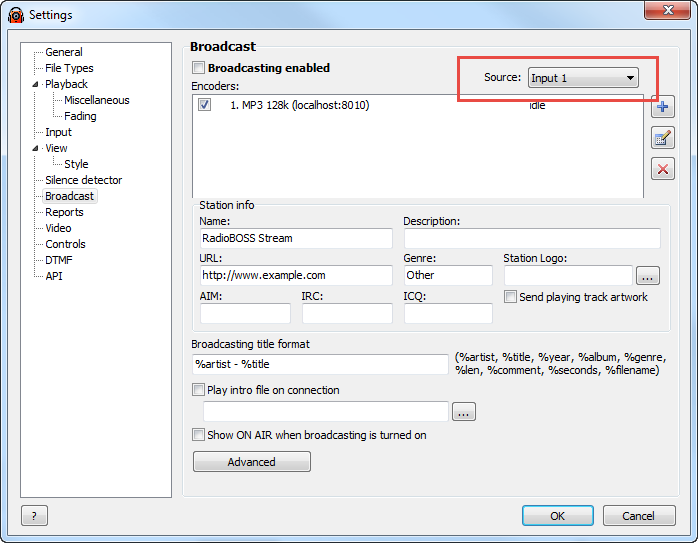

OK, then you probably need to do the following:
1. Set up "Input 1" to use the mixer output - as you're using USB mixer, simply select it there.
2. In the Broadcast section in Settings, select Source: Input 1 (see the screenshot attached)
Now RadioBOSS's integrated encoder will broadcast you mixer's output. If it still does not work, please post a screenshot of your RadioCaster settings.

Then you probably need to do the following:
- set up "Input 1" to use the mixer output - as you're using USB mixer, simply select it there.
- in the Broadcast section in Settings, select Source: Input 1 (see the screenshot attached)

Indeed! Everything goes through mixer and broadcast it through Input 1. Also broadcast had to be set up.
