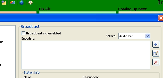

Here are my Input, Playback & Broadcast screenshots

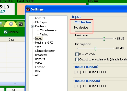

Becouse you have NO Mic in RadioBOSS.
Hello Pety
I dont want to use the mic button as there is alot of interference i want to activate mic from mixer like i was doing all along
Jay33 said:
Hello Pety
OK!
What for you use the second INPUT 2?
Usually INPUT 2 is for another soundcard, not for the same.
