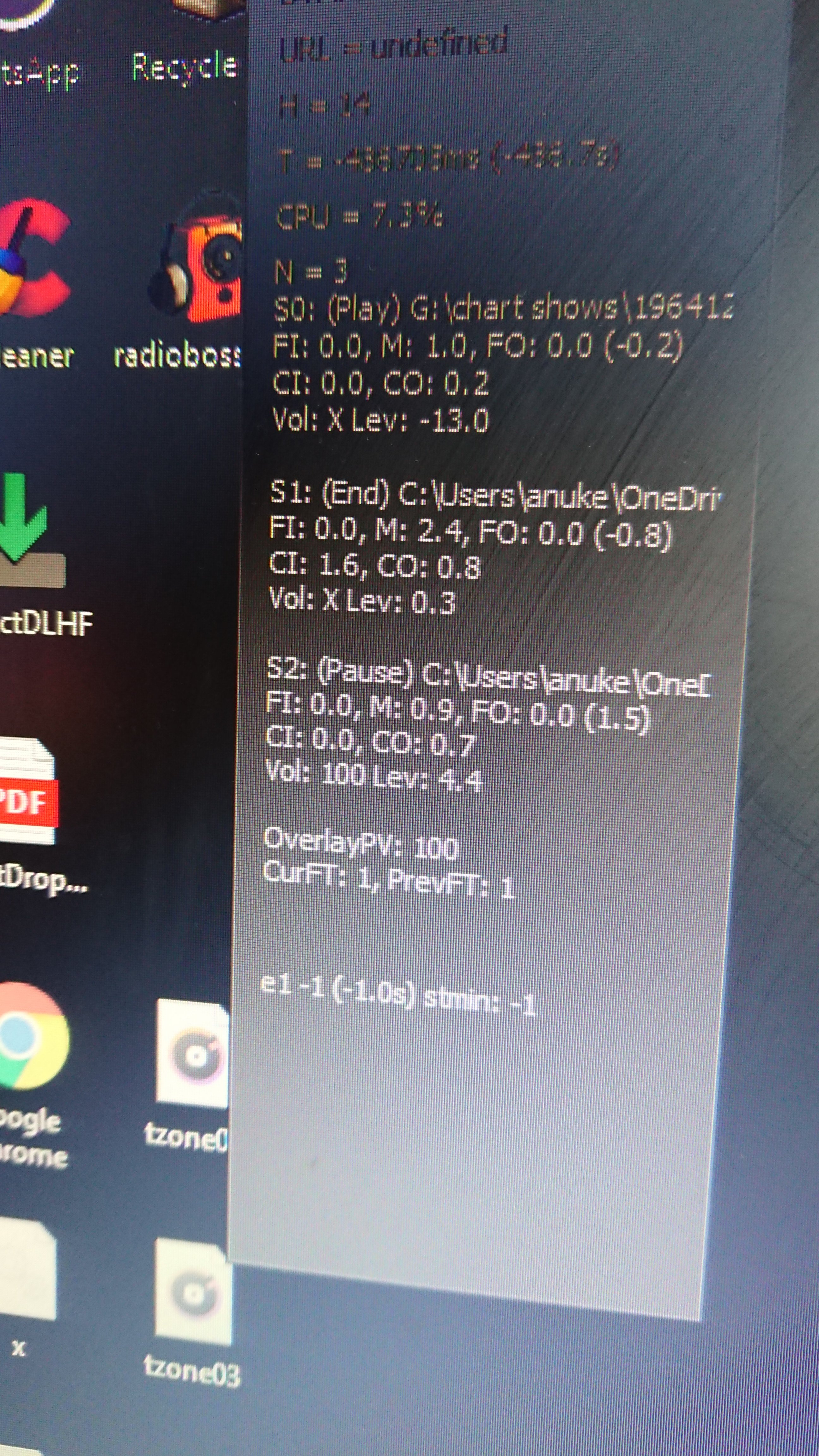

completely random yes. As I could not use it reliably I removed it and went to the previous version for the time being so I cant make a video. However the debug window just showed the volume pulled down to -13db, and nothing else changed in the window and no error messages in the main log. It only affected short file less than 30 seconds, and I did get it to repeat the same error several times during a test, but then it reverted to normal. perhaps you can replicate the issue, or others may experience it. It definitely does not happen in the older version.I took a pic of the debug window I will email i The track was set to +5DB in track tool. but as u can see, was played back at -13. I paused the playback of the following file to get a quick phone shot

The volume is pulled down to -13DB for some reason that is not clear.
Please check if you have AutoAmp enabled, also if a track has ReplayGain tag. Open it in Track Tool to see if any parameters are set (mixing options and playback level). Open Segue Editor from the playlist to see what is there (playback level is on the left).
not using the external G drive does not solve the issue. The volume is pulled down to -13DB for some reason that is not clear.
