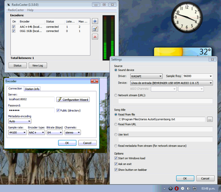

Please post RadioCaster settings window screenshot. We'll try to reproduce the error here.
I enclose a picture here,

Thank you for the screenshot. We'll test program with the same settings.
Action Radio 95.1
Do you mean settings are not stored each time after you close and restart RadioCaster? Or it just happens sometimes, and sometimes settings are stored?

How much encoders do you use? Please post screenshot of a settings window.
