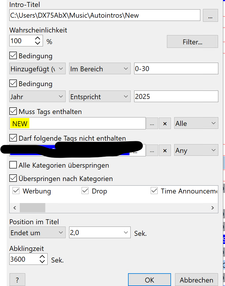

Hi Dmtry,
AutoIntro with possibility 100 % doesn't work at all with same rules I had before.
That can't be - in 7.0.8.0 it was fine. With only 35 %. Now there is no AutoIntro at all played ... I played 5 tracks in a row that usually should fulfill the conditions. I told you in beta threads ... but you wouldn't believe me so the bug is obviously still there.
Also ... and this is an annoying bug I already reported months ago ... in music library it doesn't save the personalized columns-settings so every damn time after updates I have to set it new. Why is this still a complicated thing?! I use RB on Windows vServer 2022, x86.
Edit: Ok, sorry, I found problem ... I had accidentally AutoIntro off due to command for night program I forgot. So AutoIntro is playing like it should with 100 % possibility. Now I hope cooldown also works ... I set it 3600 seconds (1 hour).
But ... the music library thing still is a problem ;-)
Please ensure that you use the latest RadioBOSS 7.1.3 as there were some cooldown-related fixes made.

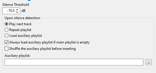

Sometimes you leave the radio on mute for too many seconds and the silence detector takes over.
It is set to play a 24-hour playlist with songs/jingles, but it is not always updated.
How can I create a command that also updates the emergency playlist when for unknown reasons the playlist generator pro cannot create the playlist?

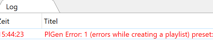

I thought you changed this into warnings instead of errors? I still get these in newest version:
"No tracks in the category" is now a warning, but actual error when it's unable to select a track is an error.

Good, I would add an option: send newly created playlist also as an option on the silence detector, if it is set to play an emergency playlist.
I think it is the third dedicated selectable button.
This wouldn't be reliable. Silence Detector is supposed to always work, but created playlist may not exist or cab be empty.
If the created playlist is saved to a file, you can add a reference to this playlist in the silence detector playlist (add it e.g. as a first track, menu Playlist->Add playlist) - in this case, it will first try to load the created playlist, and if it's not possible for some reason, play the following tracks.

I do it like that - this is why this error/warning in the error-field is distracting me because the playlist works fine though - it's ok for me when this warning would be only shown in Playlist generator like in the past. Just as a suggestion. And to be honest I am always happy when the error field is empty and I don't see any red ;)
In the past the errors were silenced so you didn't know if the playlist creation was actually with errors (unless you check the log file, which almost no one do).
Regardless of how it's shown (error or warning) it's always a good idea to fix playlist templates so that playlists are always created without errors. In case of an error the end result is undefined: certain categories may be skipped and playlist duration can also be incomplete.
