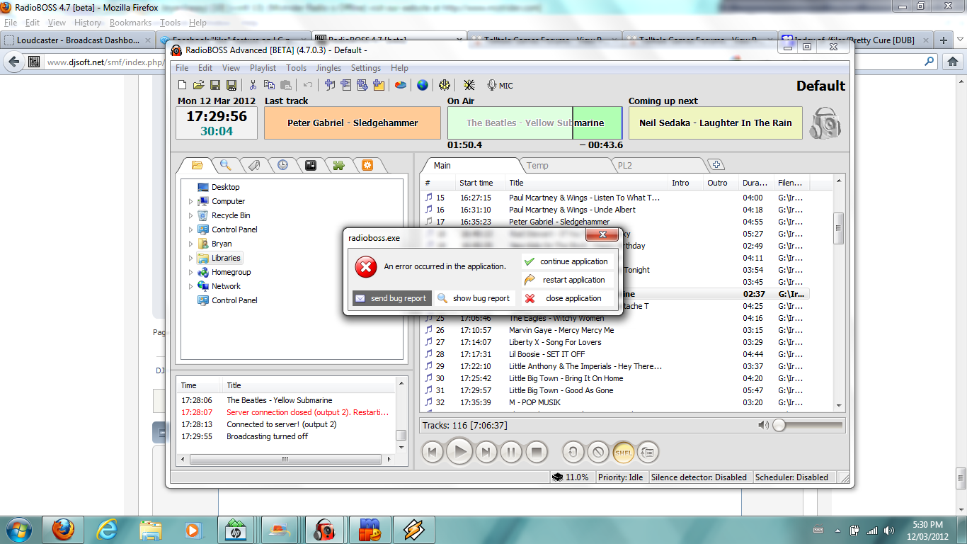

Hey djsoft
my radioboss crashed on me today while i was using the broadcast feature on it for 1 full hour
take a look at this screenshot
so can you fix this bug please
thanks

You're using an older version 4.7.0.3. This crash was fixed in the latest 4.7.0.4, please download an update: http://dl.djsoft.net/beta/radioboss_4.7_beta.exe

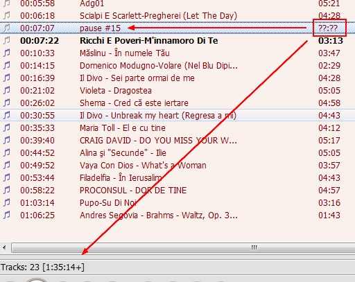

1th bug: When I insert pause in Duration is not displayed the time wich I fixed.
2nd bug: When I minimize the RB, from time to time it maximizing itself.
Thanks for reporting this.
