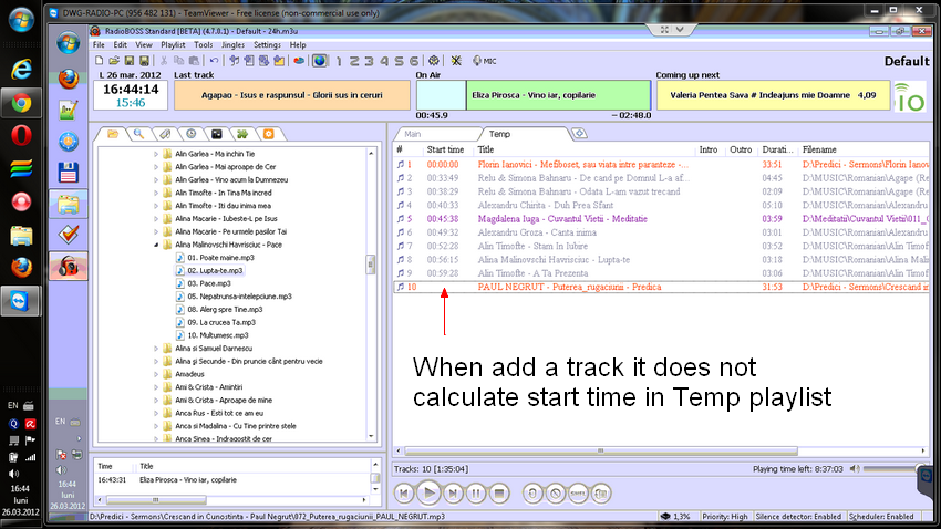

Start time calculate bug.
You'll see in image about the bug...
