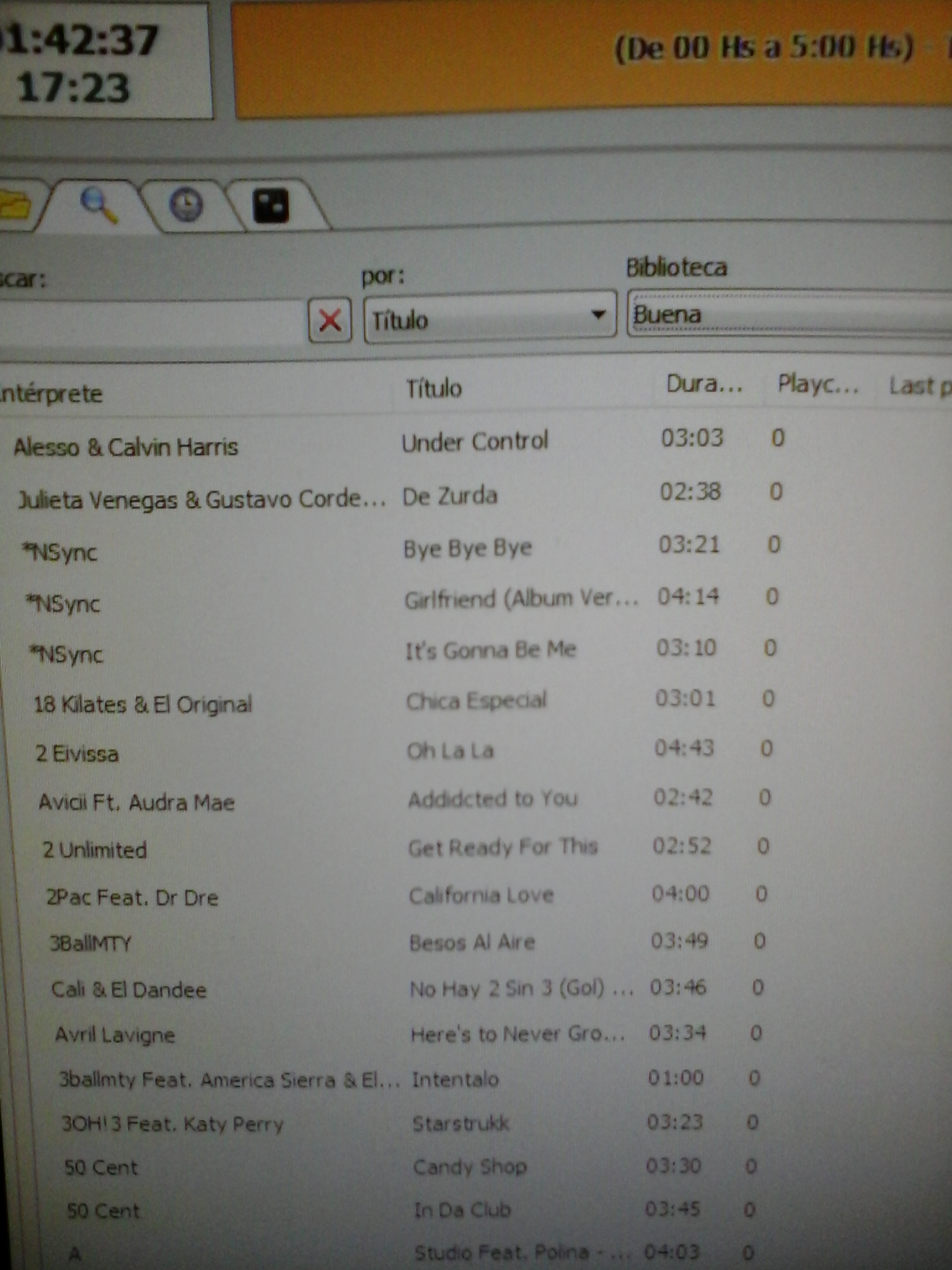

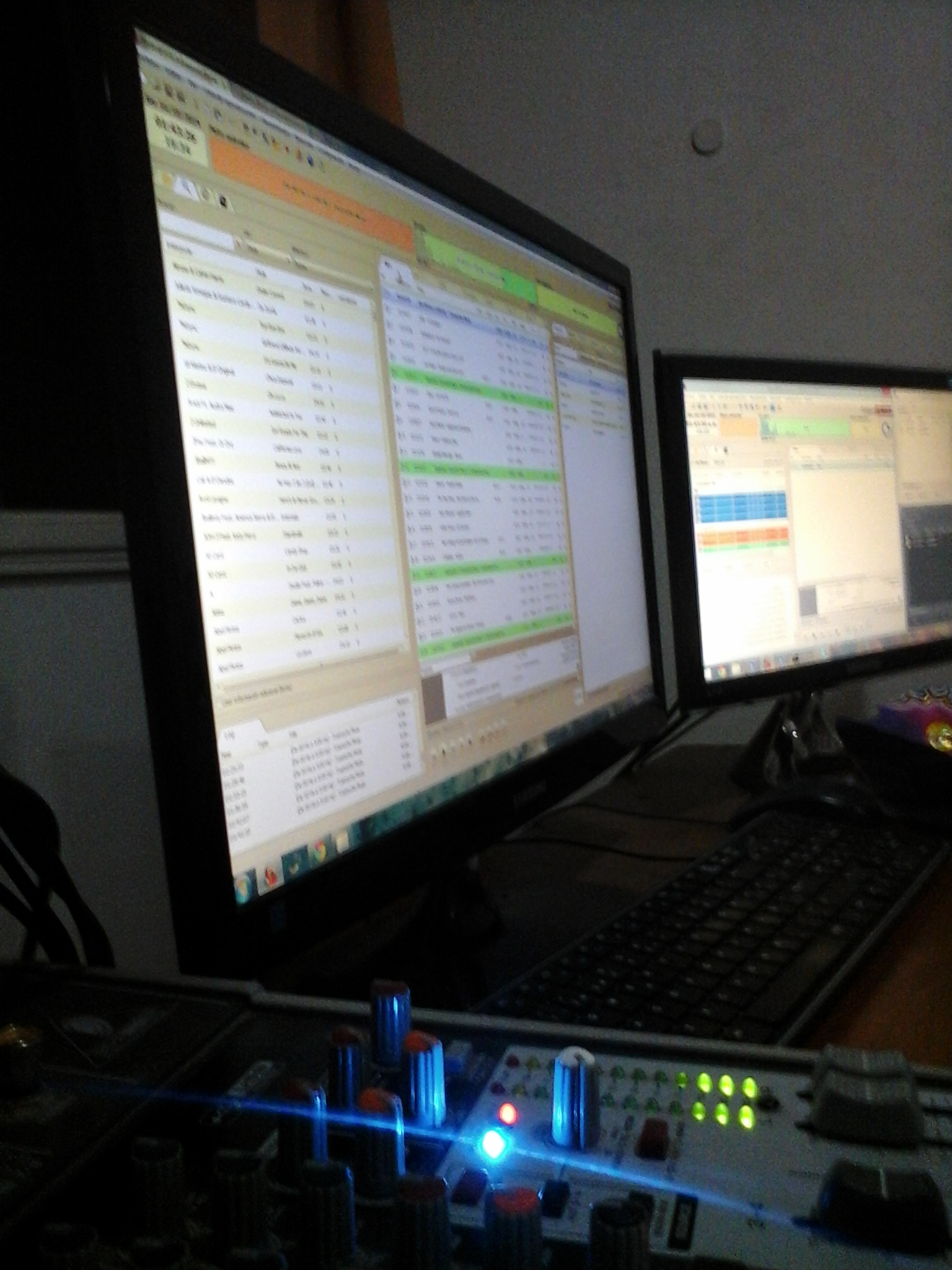

The new color lines that were included in the panel of searches are way too clear to the default skin.
Even in my LED monitors are not. (I could see that there were having with my notebook LCD screen, but even here are very clear.)
The dark skin looks good.
It depends on how your display is set up (especially contrast). Your screenshot looks OK here, the lines are clearly visible. May be we'll add a setting to control it.
So it looks on my monitor. (barely profile can be seen that it exists)

I tried saving the profile before restarting the program and the same thing keeps happening.
After the program opens the profile if I reload everything returns to normal.
Deputy screenshots
Thanks you. The bug confirmed, will be fixed in the next release.
Interesting. Could be that your monitor contrast setting is set too high, therefore grey tones are badly visible.
