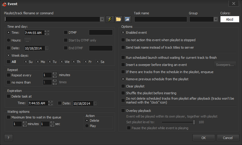

Could there be a streamarchive button to click on to activate under the options section or somewhere in the Event window when scheduling?
Action Radio 95.1 said:
yes the stream archive sorry. Actually refering to the record button beside the statistics button. It brings up the stream archive everytime its clicked on. Another idea can it some how be added somewhere to auto record a schedule program in the event section.
Yes, it can be activated from an event - see my previous post. When you click a button it will always show the window, this is to allow you to change file name and/or recording params without needing to access the settings window.
I don't think it needs to be included in the Wizard. You can simply create events which run commands
streamarchive on to start recording
streamarchive off to stop recording.

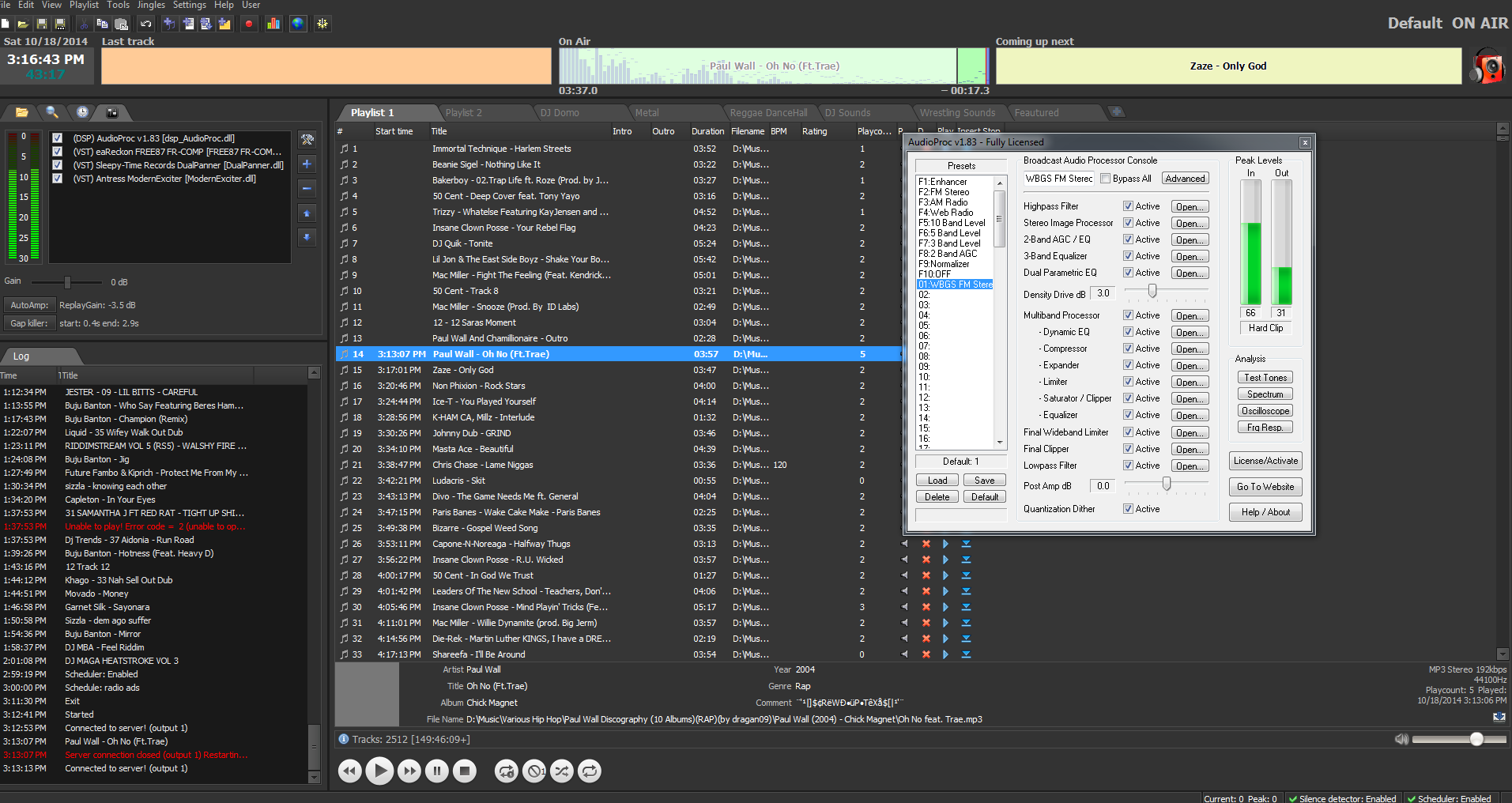

WBGS-Founder said:
That's not what happening the plugins on the music is affecting the mic only not the other way around why is Audio Proc enabled on my mic and its on my radio music? I was assuming they were gonna be totally separate.
So the plugins which are added for music (in the main RB window) affect MIC too? Please specify if you have the "Output to encoders only" option enabled.

No i don't have that enabled and the music plugins effect my mic? Also no mic button at all weird? I was messing around with this and if I go into options and then controls click hot keys and close out the mic button appears?
