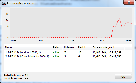

Changes:
- fixed lots of bugs (thanks to all beta testers!)
- listener number chart in Broadcasting Statistics

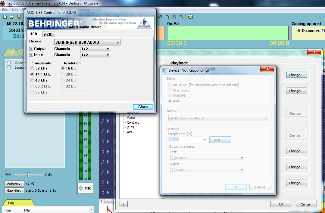

There is a big problem with Behringer ASIO in RadioBOSS.
Please wait for the next update and let me know if the issue is still there.
The same annoying bug.
Reaper is still over RadioBOSS. It manages very well Behringer ASIO CP
I am very sad about that...  :-[
See image... no change at all...  :-\
It's in the queue to be fixed.

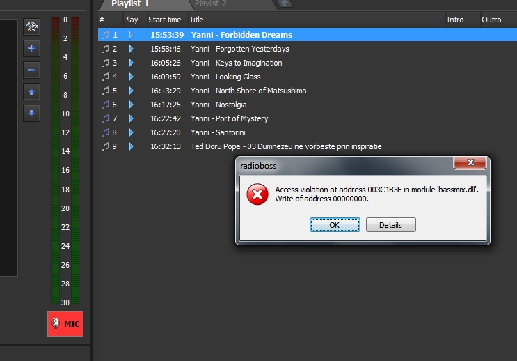

Can you please also make a screenshot of Input settings? Also, was it a one-time thing, or it happens every time? What was changed before it started to happen?
Was on a PC wich I did not use it often.
I just installed latest version over the previous one.
There where no MIC input, no settings. Just used MIC and then... crash.
I play around with the mic and change some settings for input sound card but no crash here . May be only on WIN7 is happen ?
If you start it again, does it crash?
I don't think so. Windows 7 has never been an issue so far.
