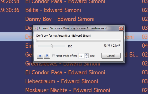

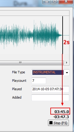

Confirm the bug in my system too. Last two seconds are not played.
When remain two seconds at the end, remaining time is changed in ??:?? and player is closing fast.
Maybe not a bug?!. Last two seconds from the end of the track are blank. And ??:?? means that blank (empty) space.

From the video it looks like RadioBOSS just removed the silence at the end of a track (like pety mentioned in the following posts). Silence trimming is enabled for preview player.

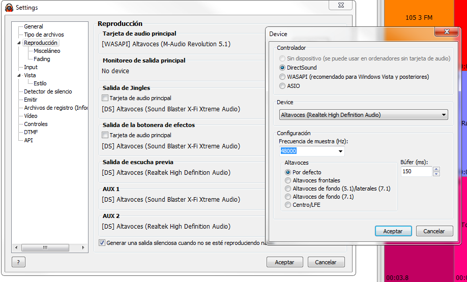

There are some problems with the preview player using WASAPI.
I could make a song cueing on this air. (according to you said WASAPI or possible)
Then try playing another track and sometimes fails and an error message appears. then try another track and it works. but I go back to play the track that the error appeared and now plays fine ... In one such attempt gender program a report attached here.
