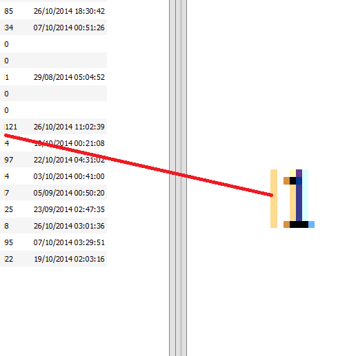

little problem to show playcount interface. (is a small line)

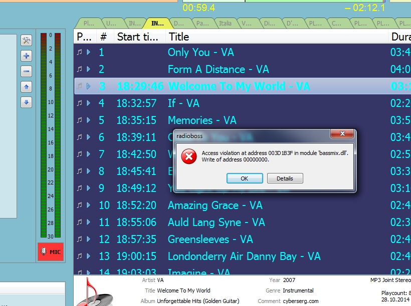

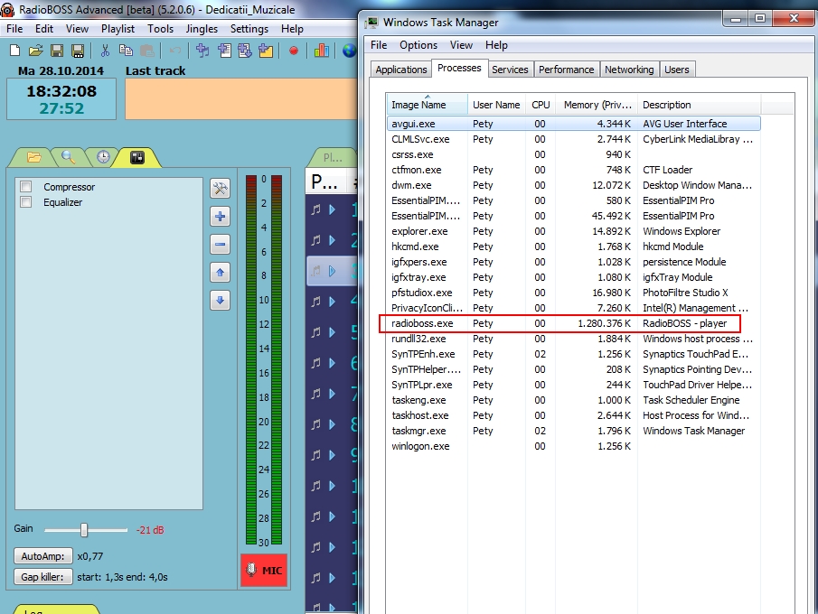

This is the worst bug I saw in RadioBOSS.
MIC crashed RB. Over 1GB RAM consuming.
Images and bugreport in attach.
The reason for this is still unknown, and we were unable to reproduce it here. Can you please provide some information about it:

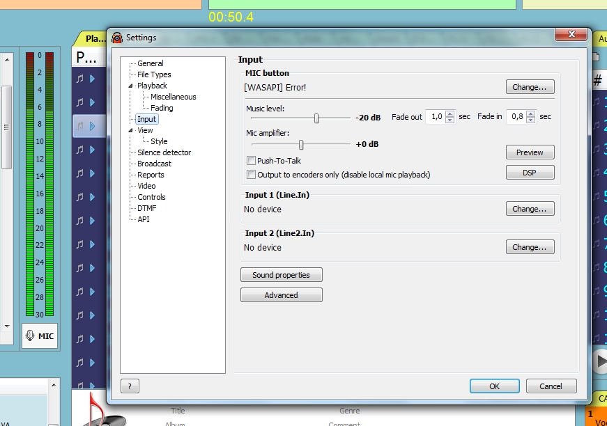

In mic was kept an old setting wich now is not anymore: [Wasapi]Error!
I know that normally when INPUT/MIC is empty (or have an old setting) RadioBOSS should alert me: there is no MIC input, or something else. But RadioBOSS took that setting as good one and it failed.

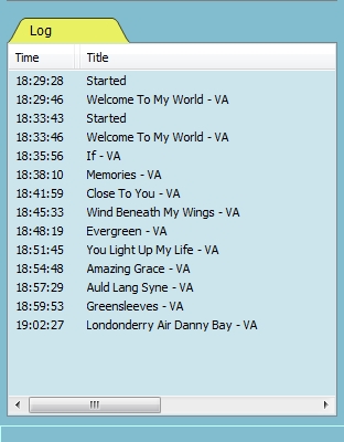

It should show a message in the log that it was unable to initialize input device. Was there such a message? Regarding the "Error!" device, you're right and of course it shouldn't crash when incorrect device is selected.
No message in Log area.
The log:
