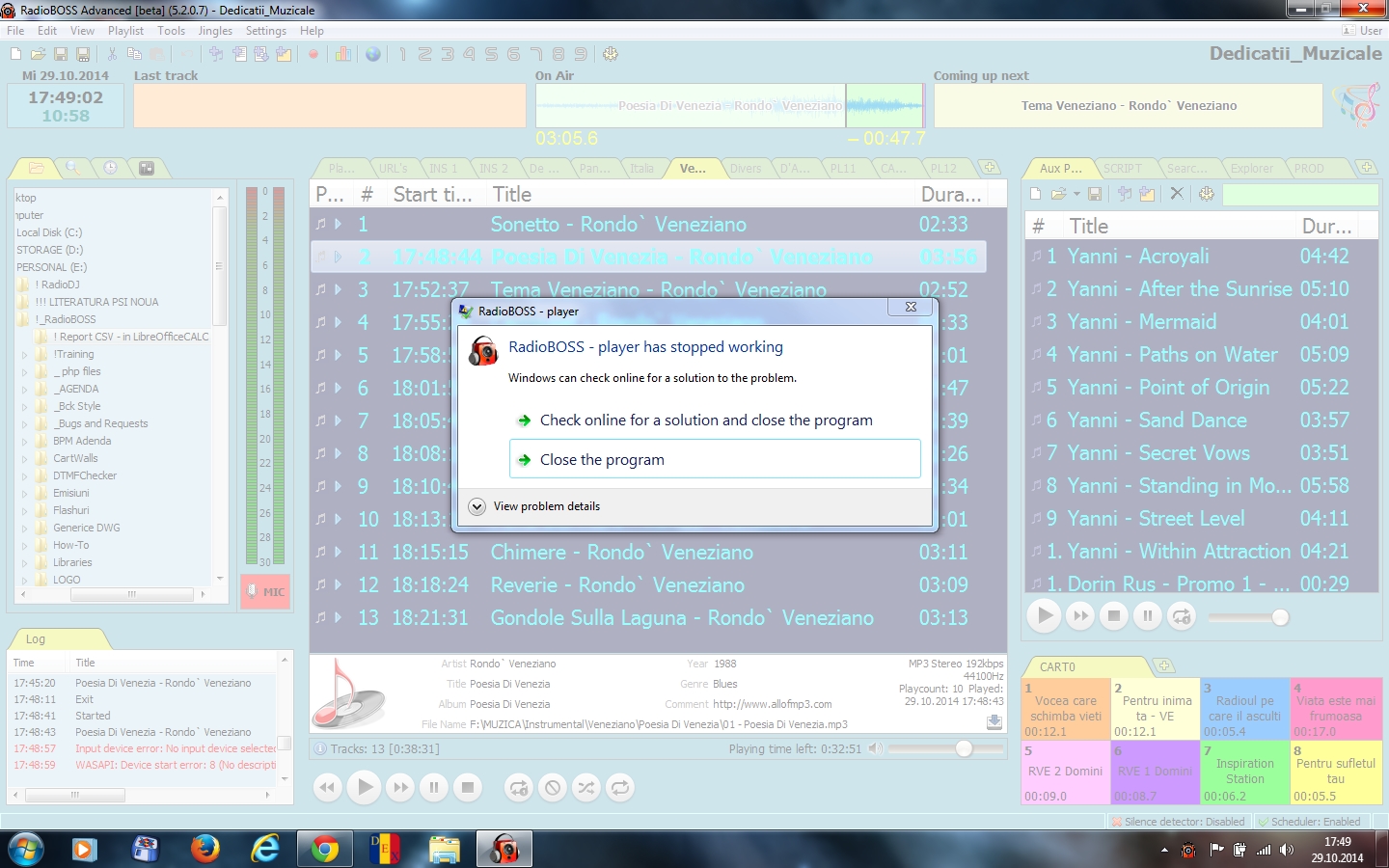

bug when closing RB 5.2.0.5:
Despite missing the program interface. I could not upgrade to the 5.0.2.6 beta because RadioBOSS was running in the background. The solution was to close the program with Task Manager
Can you please also send the previous bugreport? This one is second and does not contain enough information.

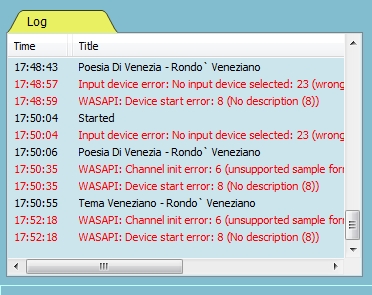

like i said something is aplying a 22050 Hz or lower sample rate and here is the errors. Sample errors.
Check your whole drivers(if needed uninstall and reinstall them) and settings on Windows sound panels.
Everything is set to 44.1 Khz and 16 bits. There is no samplerate at 22050. In MIC is nothing.
You need me to generate the problem again?
The bug report should already present in the settings folder. If it's there, please send it to support@djsoft.net

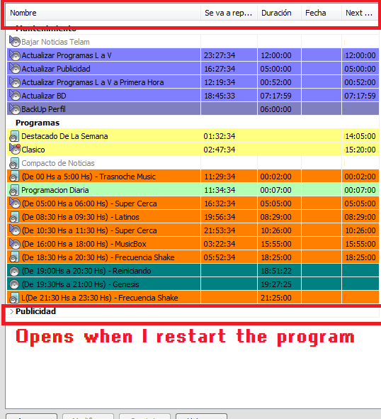

When restarting your program settings I lose the title bar of listbox event.
And again I have columns in size "0" appear
Looks like a bug - will be fixed in the next update.
It also opens groups that I have minimized.
Does not happen here. If you minimize it and restart, will it stay minimized?

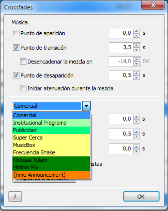

I think it is caused by the fader settings. (attached)
The voice track is played as a common track. (It is no background music playing, and then continues with the track that is inserted should aver the voice track)
But if I do the following:
After the current track insert a timed silence of a second, then insert the voice track with the song to be inserted. works as you say. but if I remove the programmed silence makes what I said earlier.

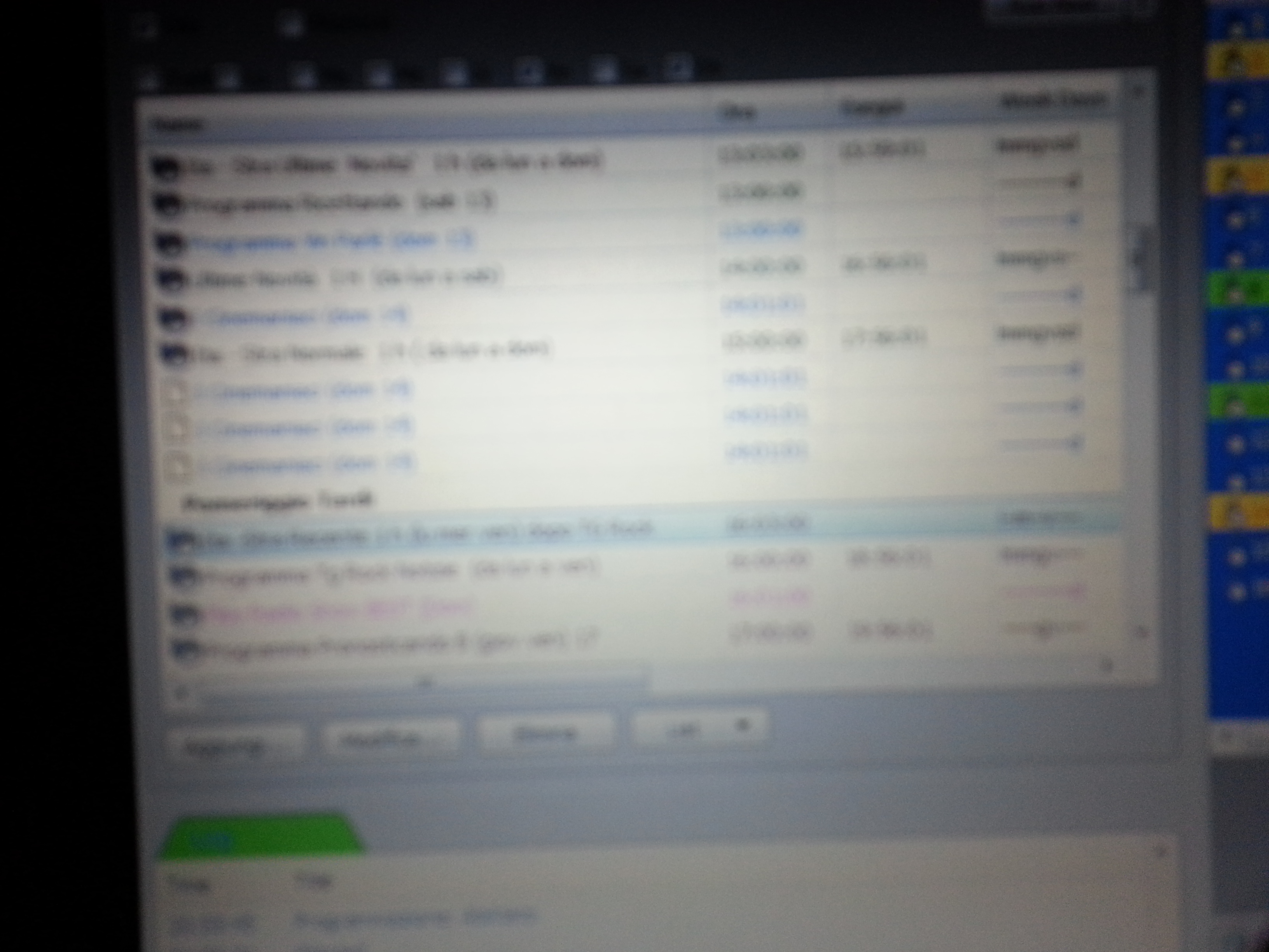

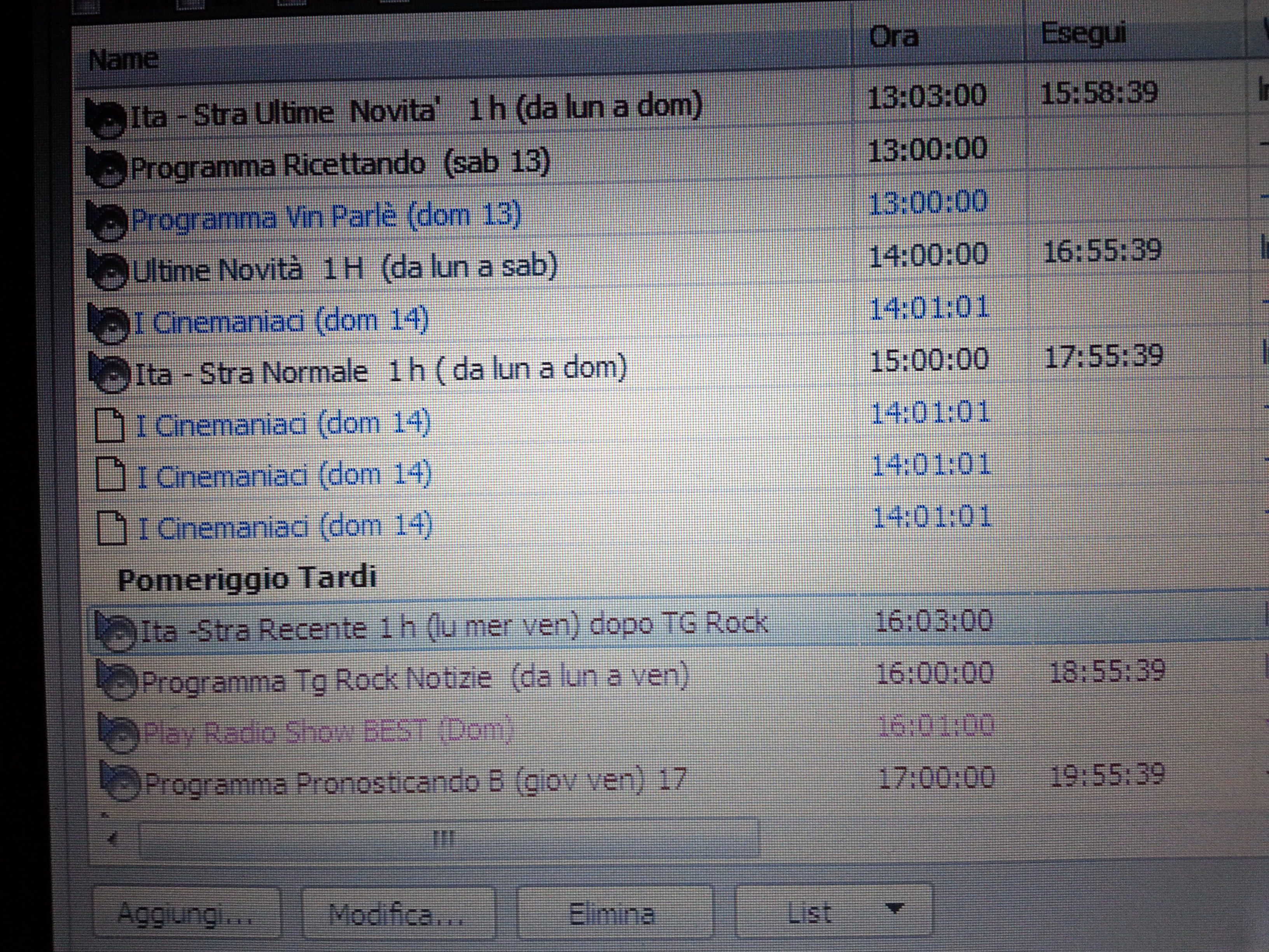

Hi, I found this very serious problem when I change the schedule very important for my radio, when I change the schedule by creating and editing, the window will begin to see these schedules ghost can be seen as an icon in white sheet, if I try to delete them I will delete even the original, then now username events in chronological order change position, then try to restore to load the last saved version of the schedule. Then everything stops and I have to reset the RadioBoss, this problem started with version 05 but restoring previous versions the bug is still there. Do you know this problem or is it just my pc? As you can see from the picture the program crashes I have to restart RadioBoss and everything returns to normal until I start again to change the schedule for events. I enclose a photo. PS. I submitted a bug report that is generated in the event of a crash ...
I do not know if you've fixed this bug in version RadioBoss 5.2.0.7  because in version 5.2.0.6 but the problem folder ghost has not been resolved. See photo
Can you please tell me what you did before this started to happen. E.g. draging events in the list, add/edit, etc?
