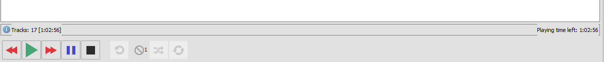

1. Minor thing in RB 5.6.0.1: the Tracks and Play time left labels appear to be overlapping the 1px frame (see attachment). Screen resolution on test laptop is 1680x945.

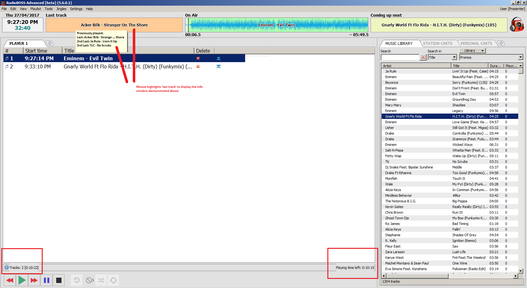

Also regarding previously played songs, it would be nice to see more than 1 previously played track, maybe previous 3-5.
It doesn't happen here... Can you please post a screenshot of the whole player window?
You can see the previously played songs in the log. The songs can also be dragged from the log to the playlist, in case this is needed.
Thanks for that. The profile we setup for presenters is blocking the log feature and our presenters can't change it (we did that to simplify the layout - our presenters are mostly 50+). Is it possible to have this information displayed like in the screenshot? Similar to how you highlight the 'On Air' section and it displays some info?
Screen shot attached which demonstrates this.
Also full screen screenshot shows the track/playing time minor cosmetic issue.
