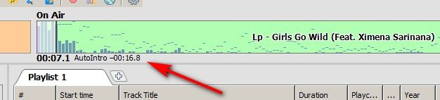

Lovely Dmtri but some of the problems are outstanding AutoIntro does not function correctly . If you place two files in the playlist and set the AutoIntro with a wave or MP3 the system detects artist superbly but if the Position:End of Track is used and a figure of 230s is used on a 3:52 song the media is cut of when the new second track starts there is no overley like the cart uses. This also does not take a calculation in the seconds box such as %seconds-6 which could be used to position the intro at the end of last song correctly. It would be also helpful if it listened to BPM to get the intro on a quiet piece so the voice did not crash the music.
Just to clarrify all the mp3 or wav files do play if they are within the whole of the song only . I have several that will play ok and not over the next song this is the real bug!  The addition of %count+6 or a calculation would be really helpful too as it would enable much better control . If the software could detect slower parts of song  monitering volume might be possible . it could be preferential to use these .
We have never promised that %seconds value will work there - you should not use it as it'll likely be treated as "not a number" and converted to zero. The idea is interesting, and I think we'll add an option to start the track based on its end.
