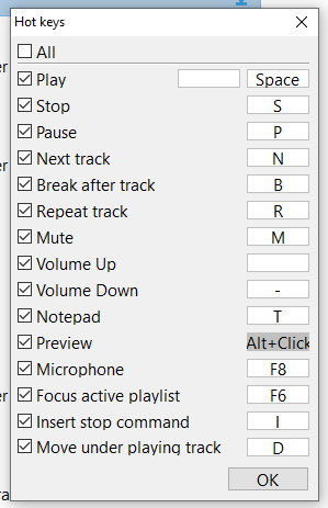

Can you please provide more details?
For example, would it be possible to have a window where you can customize shortcuts. Foe example, I might want Ctrl + P to open the options window as opposed to Ctrl + Shirt + O
Adobe Audition has something similar to what would be great to have
Alternatively, you could add all the shortcut options to the 'Hot Keys' window (Options window, Segue editor, pre listen etc.)
Voving all the shortcuts is a lot of work. If you have any specific request to modify shortcuts for certain commands, we can consider it (please create a new topic).
