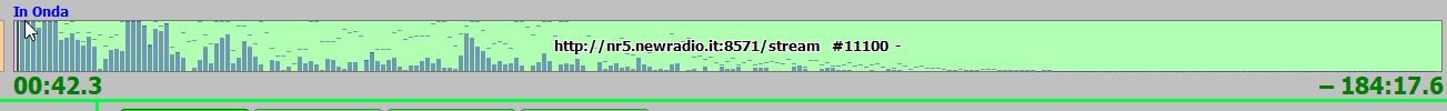

What you write is incorrect, in all, I repeat all, the previous versions it was possible to adjust the elapsed time of the stream by moving the search bar to the player. This is to fix any interruptions, if the stream stops or RadioBoss freezes, or restarts, the stream returns to the beginning as it is possible to return with the search bar to the correct position of the time elapsed now?. This happens when you schedule the live stream with a schedule. Please check it out!
We've removed that as "seeking" a network stream is not possible. If you only need it control the playback time, I think this can be added back, no big deal :) scheduled for the RadioBOSS 6.0.2 update.

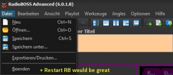

A restart RadioBOSS option would be fine iff possible ( See Picture )
Sometimes you have to restart after making changes

Makes sense - will be added in the next update.
