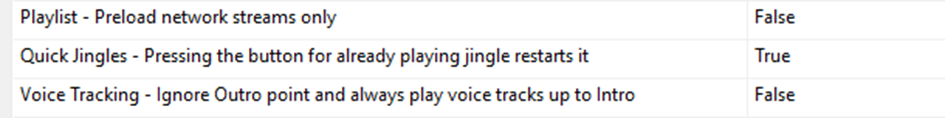

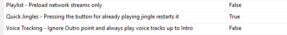

Hello. I tested the advanced option "Quick Jingles - Pressing the button for already playing jingle restart it". This feature works properly

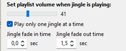

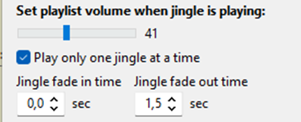

But when one jingle is playing, we start another jingle and then they both play. The first one doesn't fade out. Of course option "Play only one jingle at time" is active

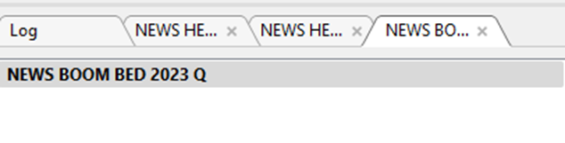

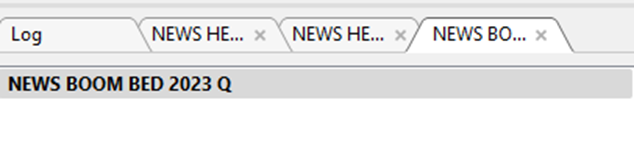

Hello. I tested "Quick Jingles" and now it works like this: one jingle plays and when we want to play the same one again, unfortunately it stops playing. What I wanted was to be able to play the same jingle assigned to the same key. During the news, we play a jingle combined with the backing track from key 1, which is 4 minutes long. When reading the news, at the transition from one topic to another, we play the same jingle - key 1. This means that it should mute the previous player and play the same jingle from the beginning. Will this functionality be included in the near future?
For this, in the jingles configuration window, you need to disable the "Play only one jingle at a time" option.
This is possible, please open Settings, General, press Advanced configuration button, and set "Quick Jingles - restart on key press" to "True".
