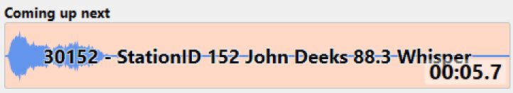

Really like the waveform on the coming up next tab. Maybe an option to change the colour of the waveform per section however? For our less advanced presenters with vision issues, they will mistake the playing track as the one on the right, as the waveform is the same colour as the current playing track. Would be good to be able to grey it out. I would also like to be able to see the waveform on the last played track for consistency/even UI.
I'd like to circle back to this. We like how the waveform is on all 3, but we're still having complaints of presenters not knowing which track is the active one due to the waveforms all being the same colour. Can we add an option to hide the waveforms (like previous versions) on the prev/next or change the colour of each of the waveforms individually.

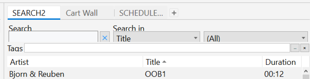

2 - The text in the Search tab gets cut off by the boxes when the text is larger on a 1920x1080p screen.

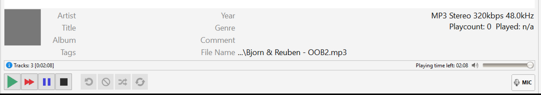

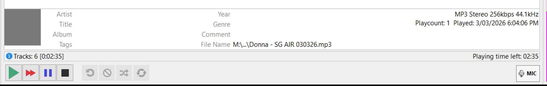

3 - The track info box is no longer able to be customised individually and no longer has a border. We've found it makes the UI look really messy.
Previous version:
This version:
Previous version:
This version:
Yes, I also somehow preferred the info box in the previous version. The white background looked better to me than the current one, which is the same color as the frame — it helped separate it more clearly as a distinct element.

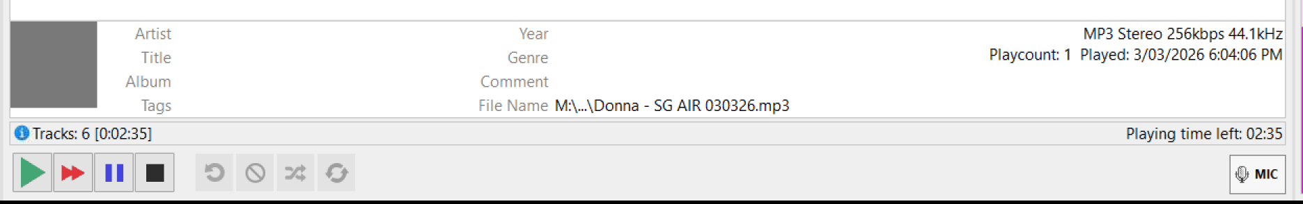

Version 7.2.0.3 - When the information for all of the columns selected for the main playlist window don't fit within the visible playlist window they can not be accessed by using the horizontal slider at the bottom of the playlist window. Previous versions allowed access to the non-visible columns by using the slider.
Yes, this is still in the queue to be developed and I think will be added in .4 or .5 update.
It doesn't look like a bug, seems that you increased the main window font too much, so it doesn't fit anymore. If you need to make everything larger, consider changing the scaling option in Windows, as this will properly scale control sizes as well as fonts. I'll see if we can add main window scaling option to the Styles so you can do it from within RadioBOSS.
Can you please specify what customization is missing? The frame doesn't seem to be ne3eded there as playlist and track info box have different background colors, so they are already separated visually.

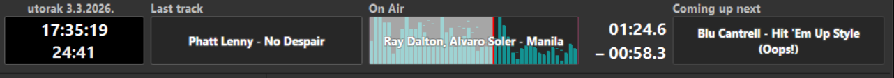

Another comment I have on the clock is that it really doesn't work with larger text, it just looks messy. Is there anything that can be done about that?
Make the Nowplaying area larger? (from View > Workspace > Customize). We're now exploring the idea of freely resizing it like resizing of the zones work now. This will allow to adjust its size as needed.
