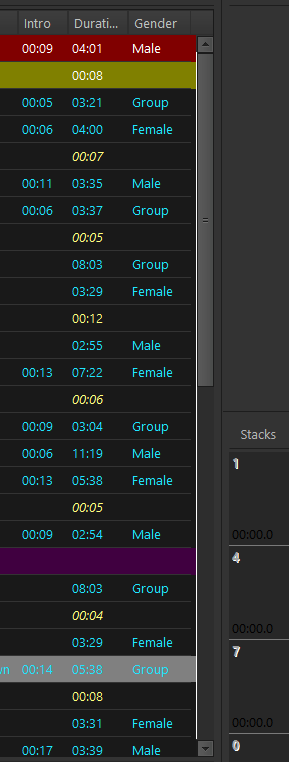

Version 7.2.0.3 - When the information for all of the columns selected for the main playlist window don't fit within the visible playlist window they can not be accessed by using the horizontal slider at the bottom of the playlist window. Previous versions allowed access to the non-visible columns by using the slider.
There's horizontal slider at the bottom of the playlist window. Can you please post a screenshot of how your RadioBOSS looks like?

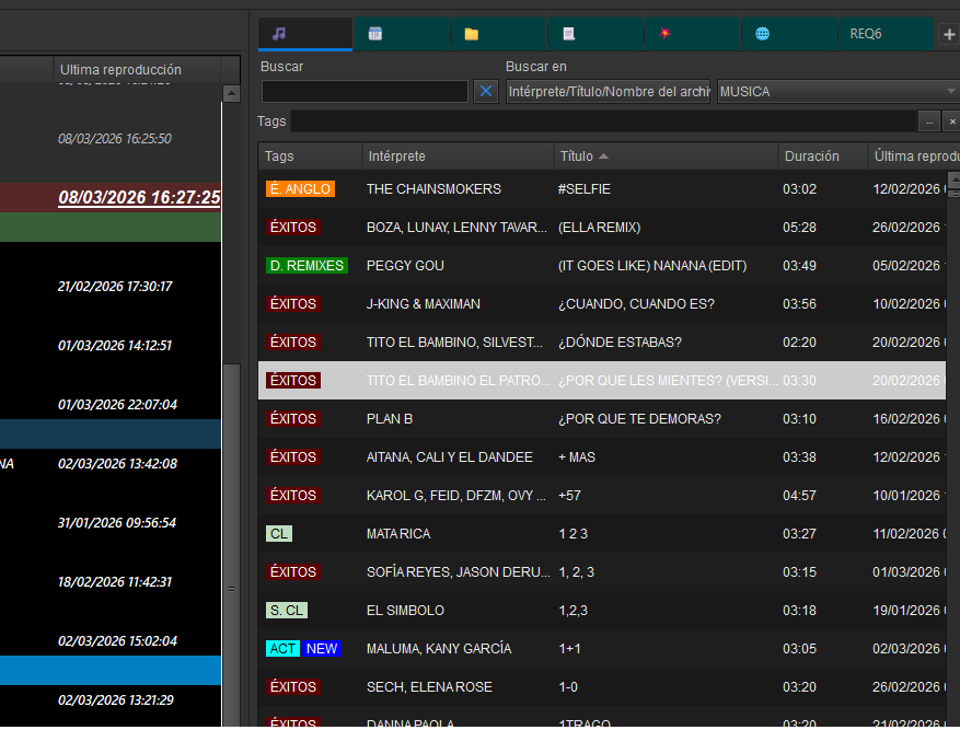

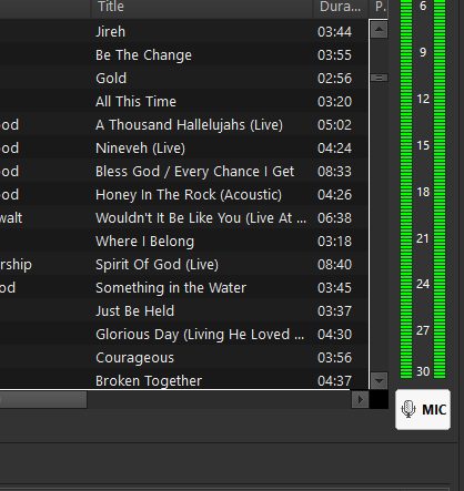

There's some creepy white color appearing as per the lastest update
Checkout out the attached images.

After selecting an area outside the search list, the selection appears blank; it is not distinguishable as shown in the screenshot.

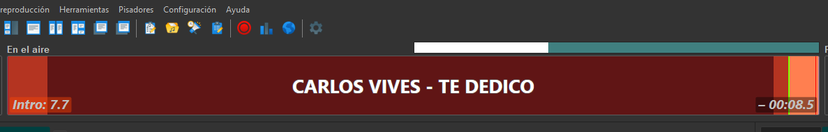

I have a complaint regarding the text that indicates “intro” inside the playback bar. It becomes confusing when it reaches the outro marker: the announcer does not know where to look because two countdown timers appear with different times. This makes it very confusing.
Wouldn’t it be better to display the word “outro” in the counter on the right side?
It really looks bad when there are two countdown timers.
Another important point: I would like the timers to be changed from 00:00.0 (longer) to 00.0s (shorter). This would save some space.
Like this:

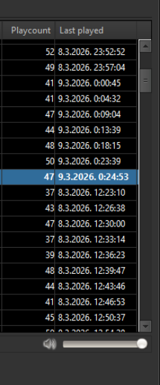

Same thing here, unless it's some new 3D effect :)

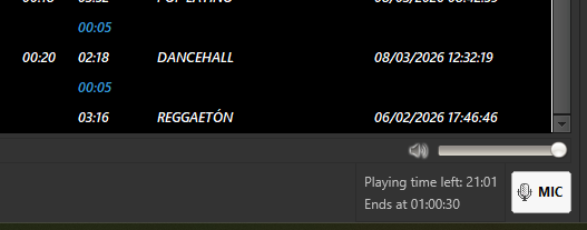

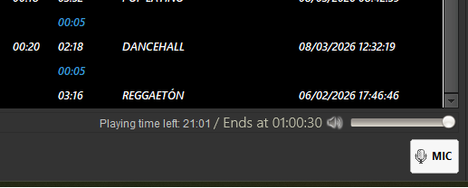

Would it be possible to make “Ends at 00:00:00” always visible?
For us, this is critical information during operation. We need to see the exact end time at all times without having to hover or interact with the mouse.
Here are a few examples.

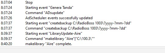

I think it would be helpful if all executed commands had a closing notification, that is, a message indicating that they completed successfully.
In this case, the `createbackup` command doesn't provide any notification.
I'm not sure what's happening with the other commands.
Adding this for all commands will be a lot of work, without any real benefit. Completion notification for the createbackup command will be added. Please let me know if there are other commands that should also have this notification.
Thank you, will be fixed in the next update.
