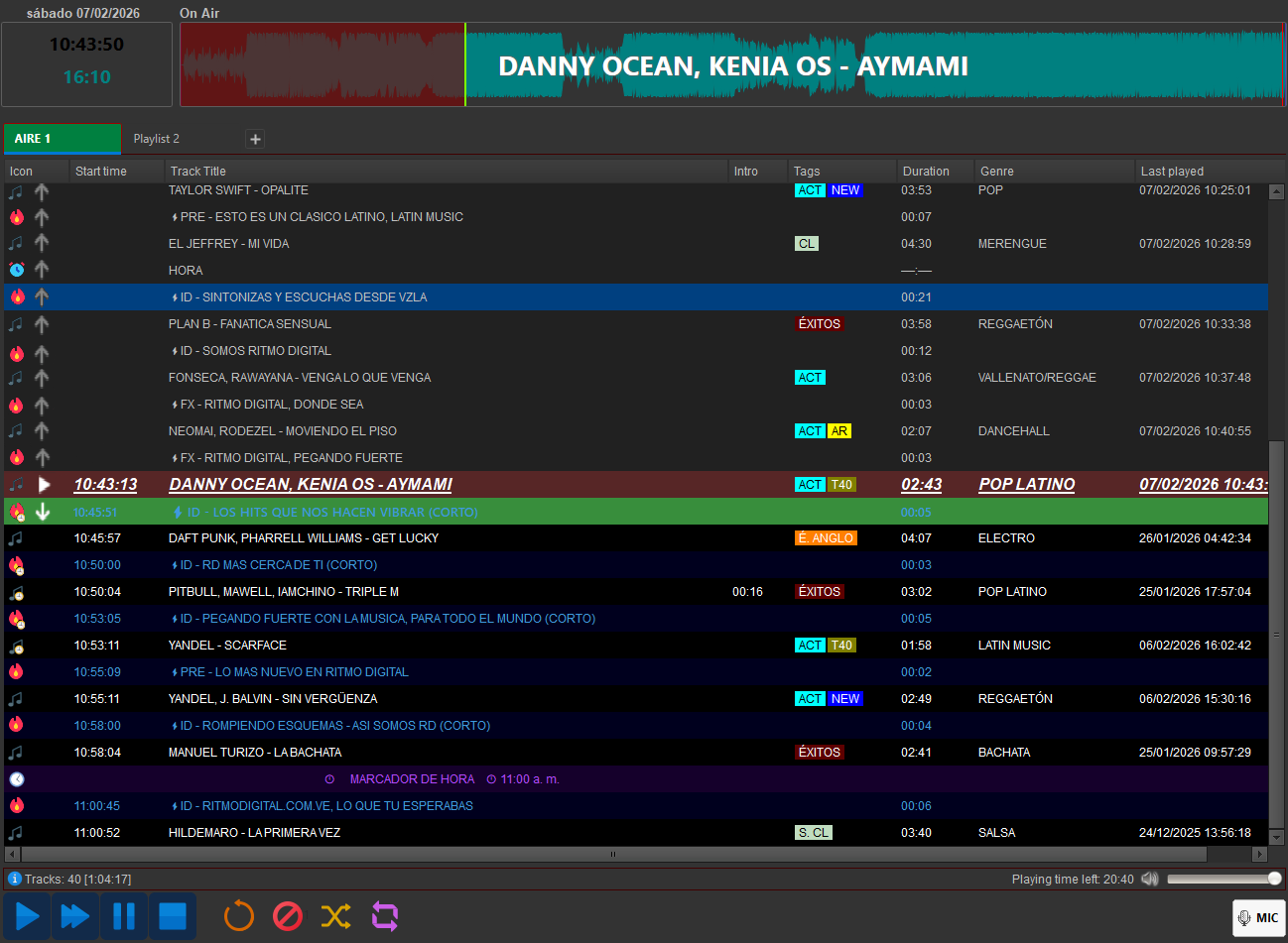

I took the time to create an idea of how all this could be implemented, and it can be done as shown in this screenshot: it displays the played status, current track, and next track, as well as a concept for scheduled elements. It looks simple, does not overload the playlist with icons, and achieves the intended goal.
What if a track is scheduled AND it's also next track? Bonus question: what if it also has a custom file type icon? That's why we decided to go with two icon columns approach. One column that's always been (note icon) and another with custom icons. The new column can show two icons, e.g. custom file type icon and also "next track" icon for example.

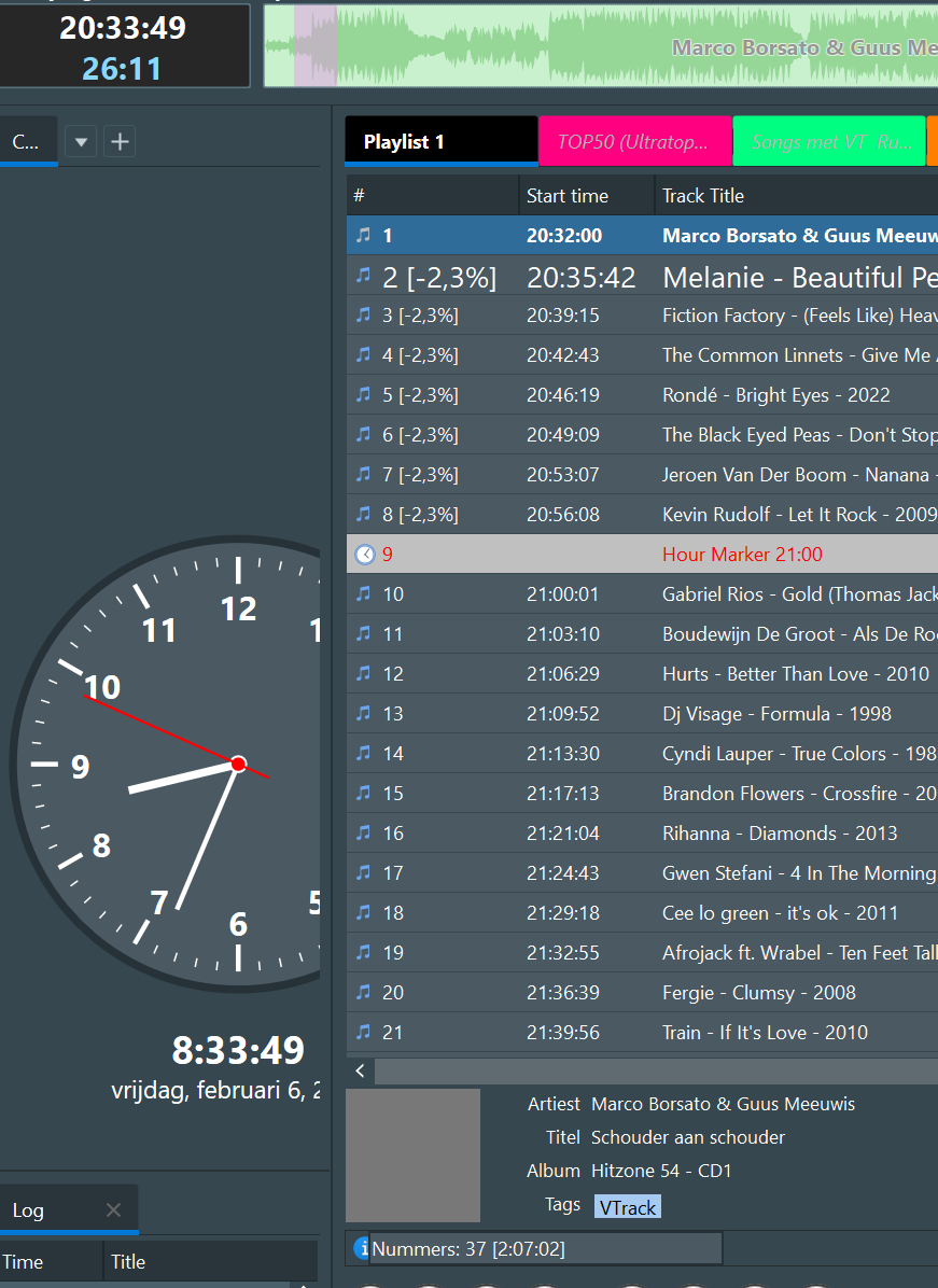

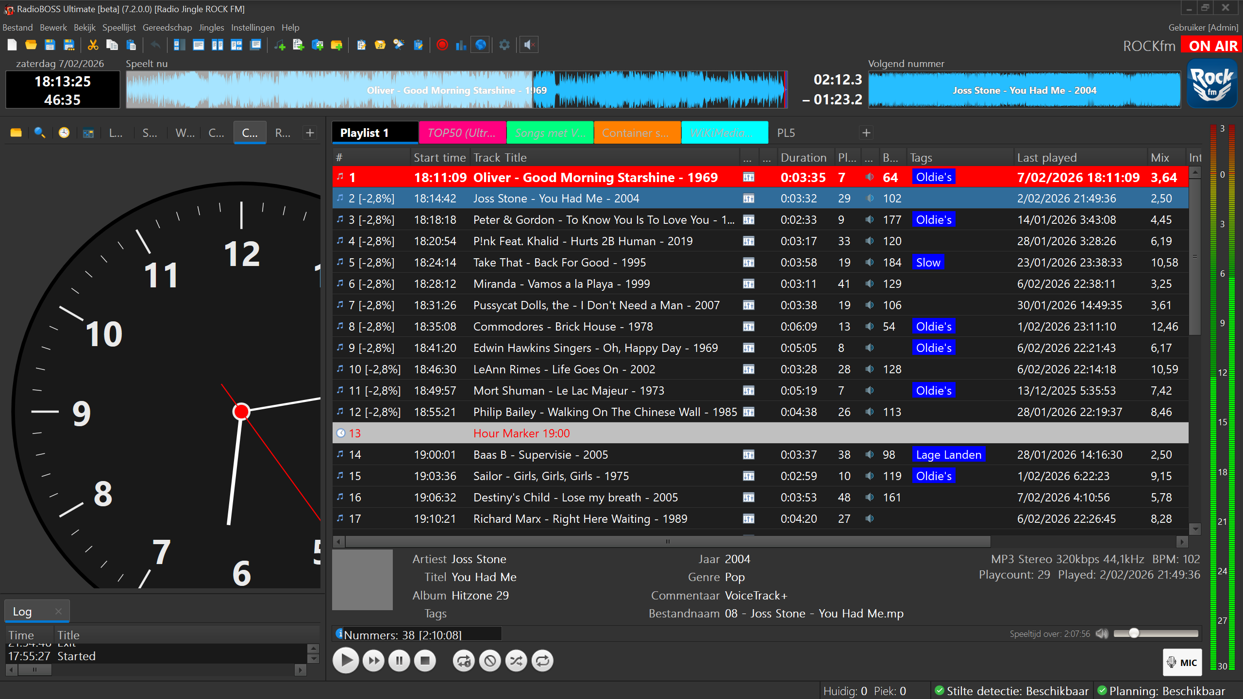

I just started testing this beta version, my first impression is that the VU meter is quite unreadable in the black skin version compared to previous versions of the RB, other impressions after detailed testing.
Maybe you have some sort of a custom style? In the default Black theme it looks pretty readable:
Do you think the background should be made darker?

So, in these cases, I think it would be better to include it in a combined column that is displayed in the following way, as shown in the next screenshot.

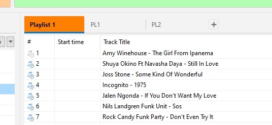

Inactive tabs are barely distinguishable (see screenshot). Maybe they could have a border, a bolder font, or additional Style options to allow changing their color and font.

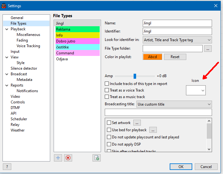

I set an icon for ads in File Types, but it doesn’t appear in the playlist, and it doesn’t seem to be saved. Every time I reopen the File Types window, the icon field is empty again.
I have the default color settings for black skin.

In File Types, could that small scrollable window be avoided? It would be nicer to have everything visible at a glance, like it was before. Maybe the Icons section could be moved into the empty space, as shown in the screenshot?
