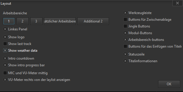

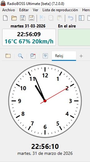

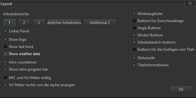

The weather data is not displayed below the time, yes it is turned on
Hello Team,
Bug Report:
Segue Editor: the next song doesn't respect the starting point and begins playing wherever play is pressed. This prevents creating a proper custom mix.
You need to ensure the weather data is retrieved - in Settings > Weather specify the location. Also the weather data is not displayed if the top panel is very narrow (so called "minimal" mode) where only time is shown.

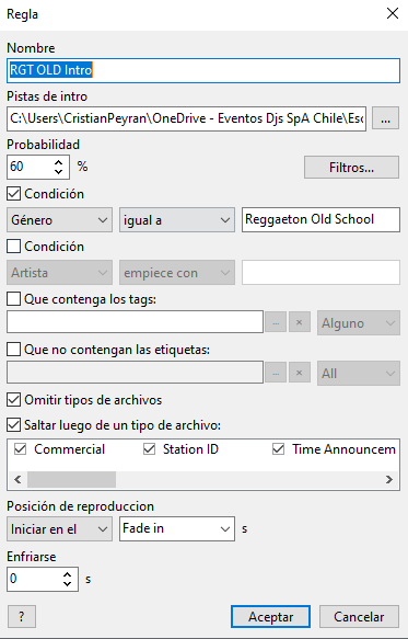

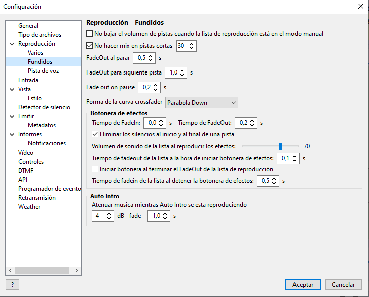

Please confirm what RadioBOSS version you use. Where is the Auto Intro positioned?
Hi!
Vers: 7.2.0.8
It doesn't always happen; I can't identify what triggers the bug, I'm trying to figure it out. I'm using it live on the radio. I understand the risks, but I think it's the best way to test it, in a real-world environment.

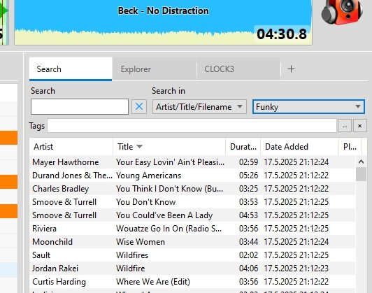

Someone already mentioned this on the forum - the tabs in the new version are poorly designed. They’re almost invisible. You can’t clearly distinguish one tab from another, and they’re nearly the same color as the background.
Something should definitely be done about this. Maybe add a darker border to the tabs, like in the previous versions.

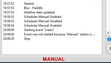

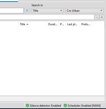

Also, when Manual Mode is enabled and the (MAN) indicator appears in the top-right corner next to “Scheduler Enabled” and “Silence Detector Enabled” it’s barely visible - it gets lost instead of being clearly readable.
There’s a real risk that it could be forgotten, which could result that ads not being played.
I suggest moving it to the status bar on the left side, below the Scheduler and Log windows. That would be much more logical - and I’d even make the label bold (or even even colorcode) to ensure it stands out clearly. See picture.
Thanks i diddnt see where to make the top panel bigger
Problem solved :-)
Problem solved :-)
Yes, the Minimal mode hides the second line from the clock area (where the weather is displayed) and also box titles at the top.
The design merely matches the current Windows design. How it's done in Windows 11.
Microsoft Edge:
Windows Explorer:
Opera web browser (non-Microsoft product - but you see the design is practically the same):
Tabs in RadioBOSS with the default style:
The point is, we have to move out of the 2010 era design trends. As you see, there's noting unique with RadioBOSS tabs. It just follows the current design trends. But, there are Style options that allow customization of the tabs (unlike the examples above where you can't control the look).
I guess we'll add an option to enable tab frames and maybe some other style options. But not radically change it, and of course not going back to "old design" :)
