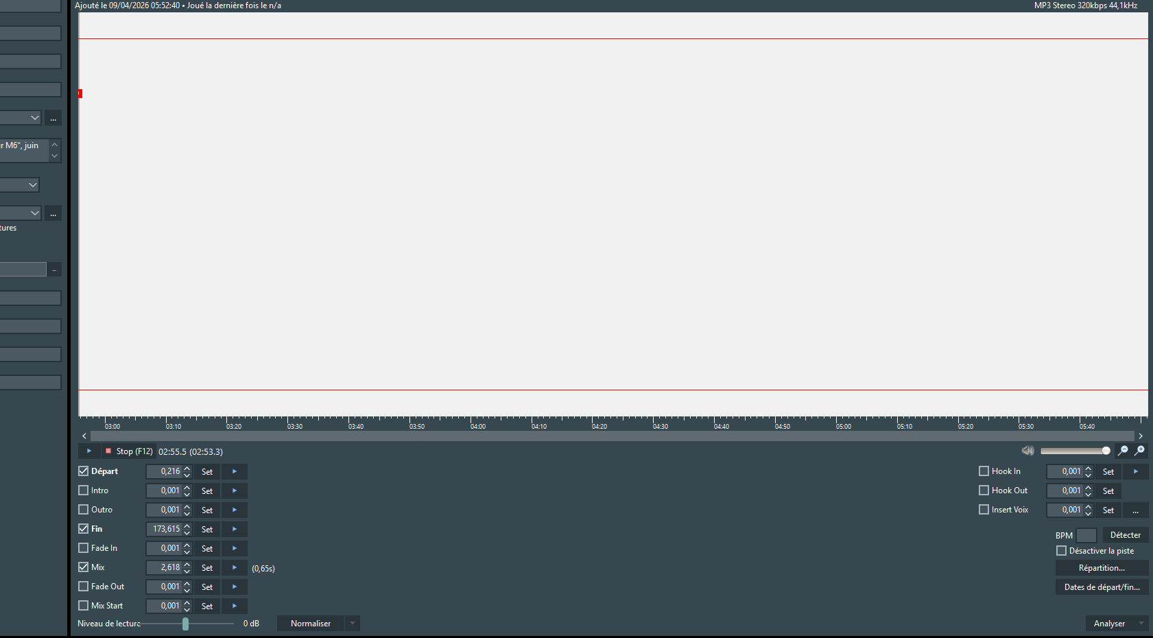

There's a display issue with the waveform: the background is white. This happens when I switch between tracks. For track A, I zoomed in. When I switch to track B, the background is either completely white or partially white (depending on the zoom level). To make the waveform for track B reappear, I have to zoom in again. Everything is normal if I don't zoom in.

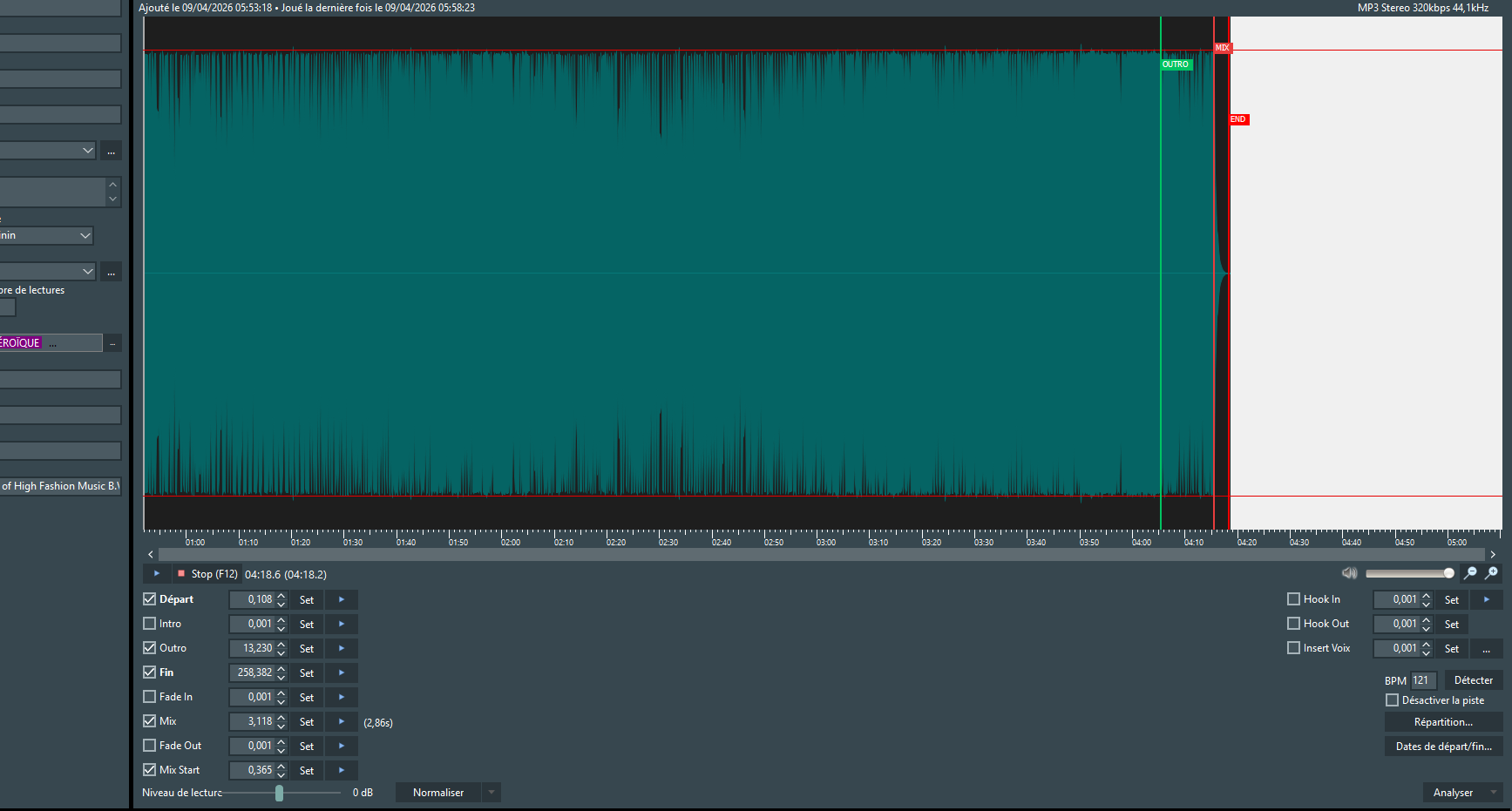

Is it possible to modify the zoom view? Ideally, the zoom should be based on the middle of the vertical selection bar (like on the latest official version).
Looks like a bug, thank you.
Do you mean the default zoom when a track is opened? Currently it's set to show the entire track.
This is the white vertical selection bar. It's the one that appears when you click on the waveform.
Currently (in the latest version), the zoom is around this vertical bar. This is useful for zooming in on the area to set mix points (start/end of track).
In this beta version, the zoom is towards the middle of the waveform. When we start from the general view (the entire track) towards a more specific point on the track.

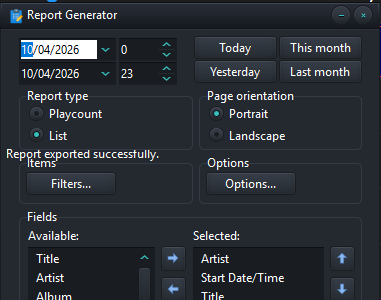

Report > Confirmation message « Report exported successfully »
The message is permanently displayed in the report window, above "Items".​
Thank you for adding this message to the translation file. And when I click "Cancel", the confirmation window doesn't appear: so it's working correctly.​

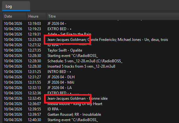

I have an artist whose music was played very frequently, and I don't know what caused this issue. It happened occasionally in the latest official version (7.1.6.2).​
It's as if the "artist" field validation didn't work correctly. I don't know how Playlist Generator works, but it seems like it missed a step during generation (occasionally).​
And it's very annoying: the repetition of an artist (especially a very popular one) is problematic, as is the repetition of the same track.​
Here's what happened:
12:23 => Artist A; Artist B; Artist C – Title A
12:32 => Artist A – Title B
Artist A's position in the Playlists:
  • Last position in Playlist A => 12:23
  • Second position in Playlist B => 12:32
For each Playlist (In "Settings" of each Preset):
  • "Do not repeat artist": 180 minutes
  • "Multiple Artists": The "Extract individual artist for repeat protection" box is checked. Artist separators: ";"
  • "Do not play tracks at the same time as yesterday": Checked
  • "Use the last played tag": Checked
  • "Repeat protection with consideration for tracks in the playlist window": Checked
    • "Maximum number of playlist tracks to check": 25
    • "Maximum number of minutes to check": 70
    • "Take into account expected track start time": checked
Scheduler:
  • An event is scheduled to generate playlist B: it was at 11:45 AM.
  • The log indicates:
    • "Playlist start time is: (today) 12:00:00 [Fri.]"
    • "Loaded tracks from the playlist window: 13"
    • "Playlist tracks repeat protection time shift: -15 minutes"
=> No errors.
Artist A is in the correct category. Both tracks are also in the correct category.
Yes, looks like a bug, it looks like it moves a week ahead for some reason. The next update will fix it.

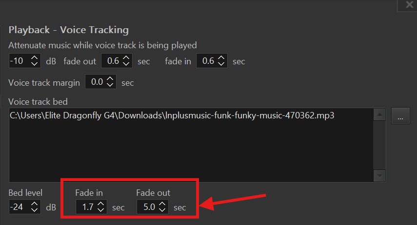

The beds were always faded out, based on the configuration, Settings > Playback > Voicetracks (for voice track beds) and Settings > General > Advanced (for MIC bed). Bed for the file type is faded out with the track itself.
What's changed is how the bed fading is implemented internally; there were several issues fixed with the Render Playlist to a File feature, as well as couple of minor bed-related bugs here and there.
The thing I've always sought clarification about is the ability let the bed fade in at the start of a voicetrack and/or fade out before the end of the voicetrack.
In radio presentations music beds typically do not just start simultaneously with the presenter talking. Usually (though, granted, not always) the presenter starts talking and slowly increases the bed volume to the desired level, and as he approaches the end of his segment, before transitioning into a sweeper or other song, he will fade out his bed for it to not clash with the incoming track or end too abruptly. It just sounds more natural for a bed to fade out and be at zero level by the time the next track starts playing, or that's perhaps my desired style. It shouldn't matter. From the screenshot attached you can see that I've tried adjusting the bed fadeout settings to -5.00 seconds. My brain tells me this is supposed to make the music bed initiate a fade out 5 seconds before the end of the voicetrack, but no matter how many times I've tested it, it has not worked. I have tried to explain this previously and you keep saying there's no problem and I'm wondering if maybe I've not been explaining it properly. Or am i misunderstanding the purpose of this setting altogether? And if that's not the purpose of this setting then I humbly request that the functionality I'm describing is added - and it should also be applicable to all the music beds selected for individual filetypes.
Preamble: Here are the elements in my player in order of playback:​
  1. Track A
  2. Vocal track
  3. Track B
I've done some testing on what you're asking for and I've noticed a problem with the Fade Out (at 5 seconds in your example):
  • The defined duration is correctly respected when Track B has an Intro;
  • The defined duration doesn't seem to be respected when Track B doesn't have an Intro: the Bed's volume drops very quickly. There's a slight difference between a Fade Out at 0 seconds and a Fade Out at 5 seconds. But it's very fast for a Fade Out at 5 seconds.
I suggest modifying the following behavior:
Settings > Playback > Voice Tracking​
"Ignore Outro point and always play voice tracks up to intro": the box is checked.​
The Voice Track plays correctly up to the intro of Track B.
Problem: The Voice Track is overlapping with Track A. Track A and Track B play consecutively, and the Voice Track overlaps. Therefore, the Bed is not played.
The behavior should be different at the beginning of the action: the Voice Track should ignore the outro of Track A. The Voice Track should play after the "End" of Track A.
Thanks for trying to test it!
You are indeed correct. I've checked it too. The fade out does seem to apply only when the track that follows has an intro. However, it appears to function as more of a crossfade setting for the bed rather than a fade out setting. I now realise the 5 seconds I set seems to be the time it takes for the bed to fade out *after* the next track is triggered. It's also no wonder it does not let you exceed 5 seconds. It's treating it as a fade out for the crossfade rather than a fade out for the bed in isolation. And yes, when the track that follows has no intro it basically doesn't seem to work at all.
What I'm seeking is a fade out of the voice track bed to zero before the next item is triggered to play, whether or not that track has an intro.
Desired result: if fade out is set at 5.0 seconds (or whatever time the user prefers), when there is 5.0 seconds left before the end of the voice track, the music bed begins to fade out such that by the end of the voice track the music bed's volume level is zero and the presenter can then smoothly cut to a commercial break or sweeper. To me this sounds more 'normal' for personality based radio shows. Ideally this should also apply even then the next track has an intro. Can't it be made possible for the music bed to fade to zero under the voice track before the next track starts playing? If not I humbly request it be considered by the team.
Interesting, thank you.
You need to verify that everything is configured correctly. Do repeats only occur across different playlists?
In your case, maybe try unchecking the "Take into account expected track start time"? When unchecked, it will consider as if all tracks in the playlist window have just been played.
With the new Start Time thing, if you have it set, you need to ensure it's set correctly for all playlists, and also that playlists actually start at this defied start time.
It fades out the bed when the bed is supposed to end - for instance, when a music track starts while a voice track (with bed) is being played, the bed is supposed to stop at this point, because there's already music (beds only play when there's no underlying music). And this is the point where this fade is applied.
The main thing about beds: they only play when there's no music track playing. So in a typical voice track scenario, when a VT starts at Outro point of the playing track, it plays together with the music, then the music track ends, VT continues and bed activates - until the moment when the next music track starts.
