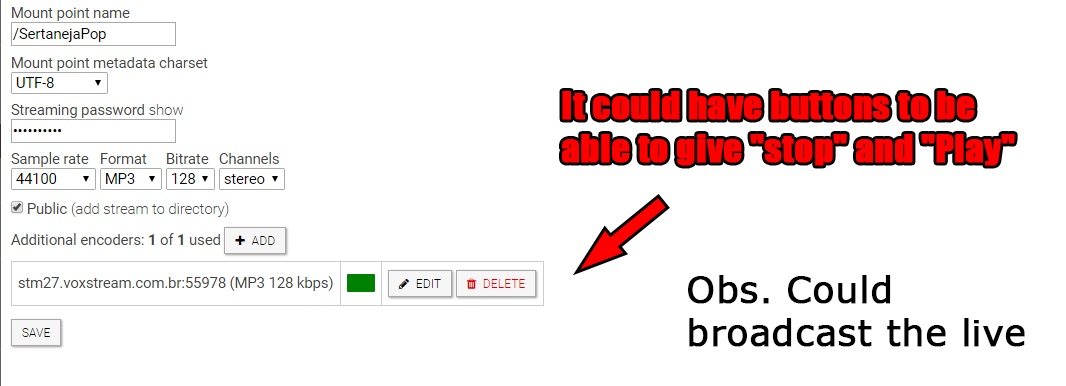

Wheslley said:
In the future the encoder could be stopped with "Play and Stop" buttons, it would be essential.
Can you please provide more information?
Currently you can enable/disable encoders - click the Edit button, and uncheck the Enabled option at the top. After you click OK, encoder will be stopped. In the future we'll add a more convenient way to enable/disable encoders.
