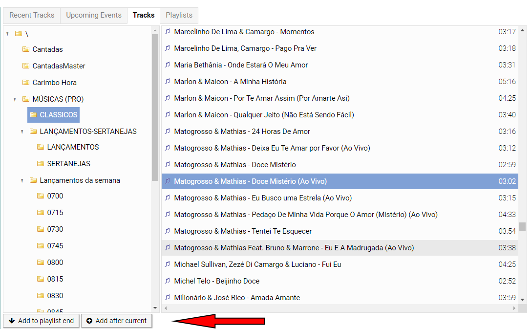

It would be nice to have a similar button on the side with the function of adding the song but removing it after having executed it, because it happens to me a lot to add the song and forget to remove it and repeat this audio several times.
