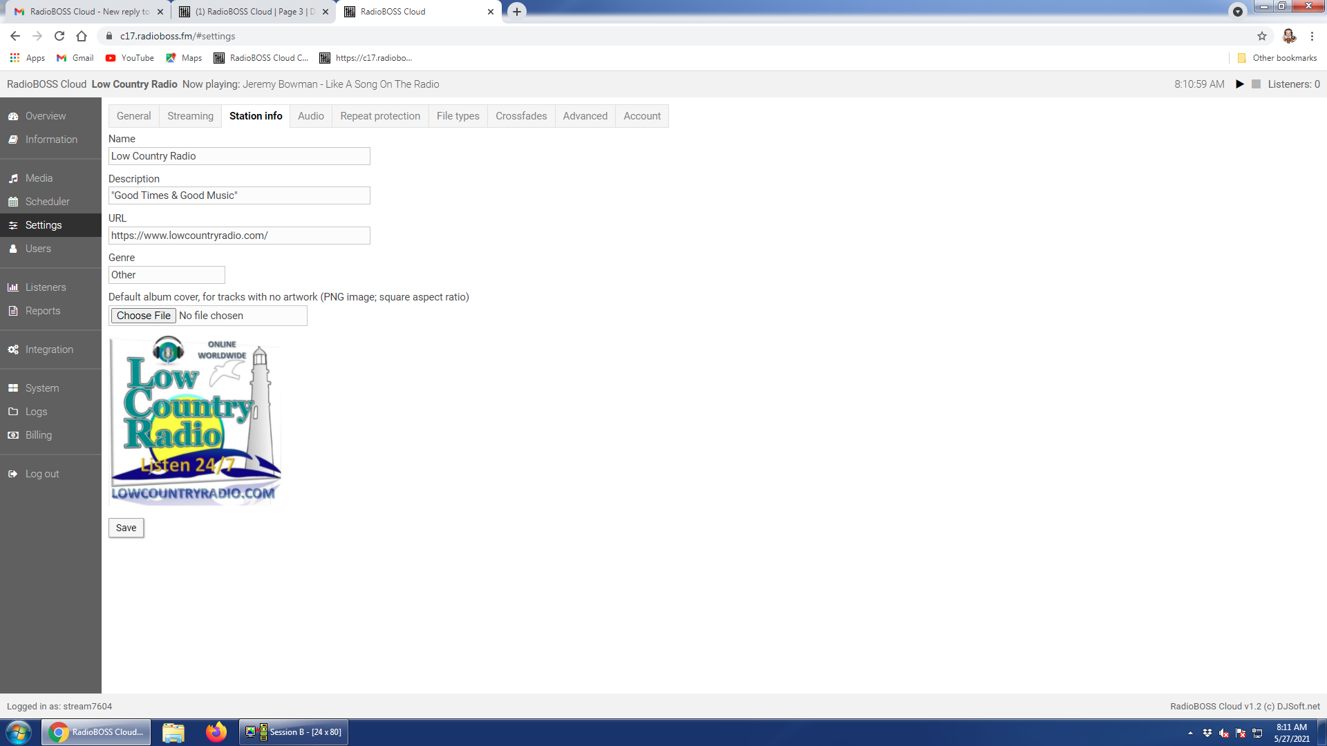

Question: when i pull up my station on my car radio through my iPhone, instead of it saying my station name, it says radioboss.fm. Is there a way to change it?
It depends on what app you use to play the stream. If it's capable of reading the titles, you will have them displayed in the car. If you simply open the link in the web browser, it will not read the title and you will see URL or domain name instead of the title.
